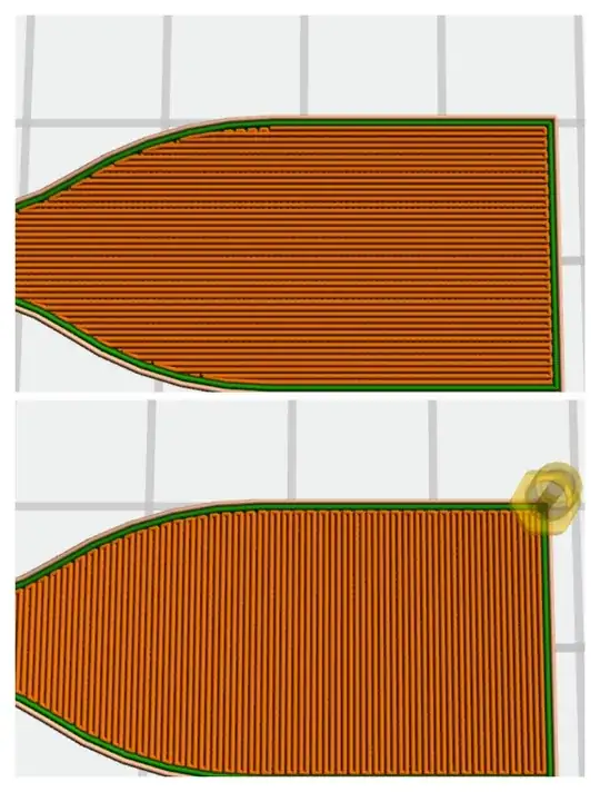

I use "Flashprint 5" as a 3D print pre-processing software. I want to have a 0-degree raster angle for all its layers (100 % infill density), in the attached object below. But what I found is that each layer always alternates to 90 degrees. Any solution for this case?
Raster Angle 0 degree (above) and 90 degree (below)

Looking at Flashprint expert mode, I don't seem to find options to change this.

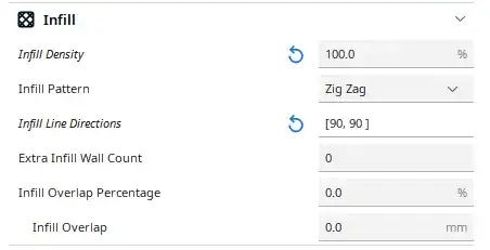

Yes there is by using a different slicer, e.g. Ultimaker Cura. In Cura you will be able to specify the directions of the infill layers as you want them to be using the Infill Line Directions printing property. Default the property is empty ([ ]), but could be changed to [90, 90] or [0, 0] (or any other arbitrary angle).
Print option is found under Infill:

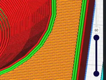

Layer 60:

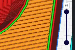

Layer 61:
You can take this even further in Cura by specifying directions for more than 2 layers, e.g. [-45, 0, 45, 90] will give you an alternating pattern of 4 layers.
