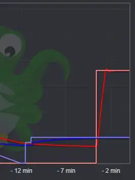

I just replaced my motherboard with a new SKR mini e3 v3 and changed the config files myself based on this Consolidated Marlin Guide.
Unfortunately, It is taking over 10 minutes to heat up the bed which I've never experienced before. I've checked the voltage going into the motherboard and confirmed it is 24 V. I took a look at the thermistor but I can't tell if that's the issue, I've changed the thermistor on the hotend before and that seemed like a different issue. I'm not sure if there's something in the firmware I missed. (also another problem that's not important but if someone knows the solution that would be great, the stepper motors are quieter than ever which is nice except when homing or leveling, then they sound like
Screenshot of Octoprint' temperature details
This is the end of one of the bed trying to heat up, I turned the printer off because I didn't want to damage the printer.
