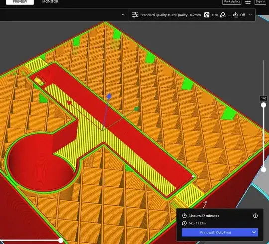

  • Load the STL. Slice and preview. Use the slider on the right to find the layer number which will still expose everything below (with possibly 1-2 layers of margin above, as sometimes the resulting pause point is off by that much). In the example, the layer# is 140. The sockets for LEDs are already closed on top, so the LEDs won't stick above the print level, so this is about the correct height.
Project sliced and height in preview adjusted to desired point

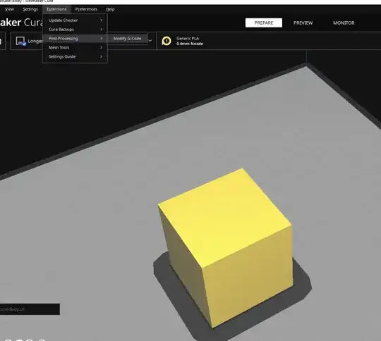

  • Select Extensions > Post-processing > Modify G-Code.
Modify G-Code menu option

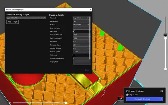

  • Add script > Pause at Height. Change "Pause at" to "Layer number" and enter the layer at which you want the print to stop, so you could load up all the electronics (or first part of it, if you want multiple pauses). Usually this is all that's needed, but if you see options you want to tweak, now's the time. Press Close.
Modify G-Code UI

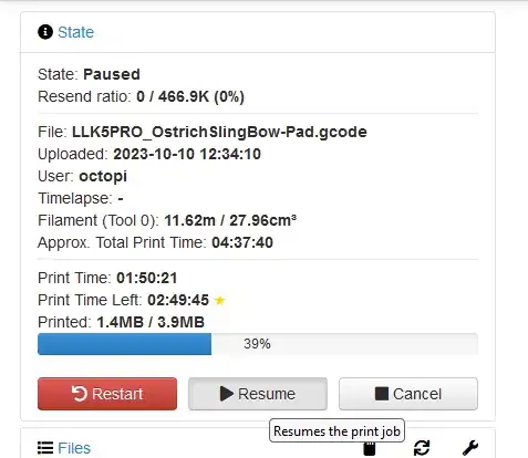

If everything went well, the printer will stop printing at the specified layer and move the print head out of the way. You can now pack all the electronics in (pay attention not to move the table), possibly hot-glue the wires so that nothing sticks above the print surface so the print head won't snag on it, then either use the printer's screen's dialog (if you used an SD card), or Octoprint's "Resume" button if using Octoprint, or whichever way of resuming the paused print your system provides. The print will resume and your parts will be seamlessly embedded within.
Octoprint UI
