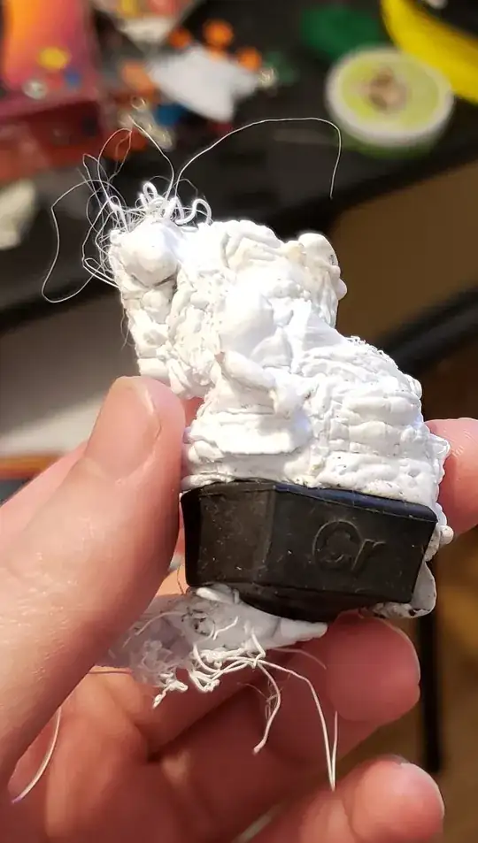

Well, I know what my critical error was, I was in a hurry and set a print running before leaving it unattended for about 8 hours; came home to a great enormous disaster.
Photo of a large mass of filament sticking out of a silicone sock

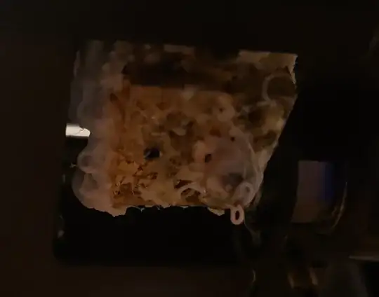

Photo of the printer head from below showing filament and residue
What on earth happened? Perhaps more importantly, is anything here salvageable, or do I just need to get a new printhead?

I'd say you are quite lucky, the hotend (as seen in the second photo) is fairly intact!
I've had a similar problem recently, but in my case it destroyed an Ultimaker core module hotend, and salvage would have taken too much time.
What happened during this print disaster
What probably happened is that the print has become unstuck from the build plate or a part of the support is caught by the hotend blocking the deposition of filament to the print object and instead it ricocheted back against the nozzle. This is not uncommon.
, and is it salvageable?
I'd say yes. You should be able to get the silicone sock off and clean the hotend. Heating the hotend and scraping it off seems do-able from the photo you provided, it may require some time and elbow grease.

It's difficult to determine if there is anything inside this mass of plastic, but a heat gun applied carefully will allow you to extract it.
When a hot end is assembled, the heat sink (finned cylinder) has a heat break threaded into it (slender metal tube) which then threads into the heater block (block with wires for the heater cartridge and thermistor).
The heater block has the nozzle threaded into it, but it's important to not seat the shoulder of the nozzle on the heater block. Leave a gap of 0.5 to 1.0 mm between the nozzle shoulder and the heater block. Tighten the heat break into the block until it contacts the nozzle. Secure it firmly, but don't snap anything off!
Heat the assembly to the highest safe temperature, between 220 °C and 250 °C and tighten the nozzle again.

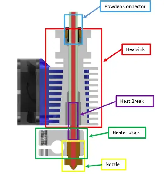

Step 7 from cnx-software states the same thing as the paragraph above, but also provides a graphic showing the components:
E3Dv6 clone hot end assembly
Your photo shows the results of a nozzle that might have been leaking filament at the top of the nozzle and below the heat break, leaking out of both the top and bottom of the heater block.
Melting the plastic with a heat gun may release the metal components and if you are very careful and very lucky, you won't damage the wiring for the heater cartridge and thermistor. One can expect that the wiring will be damaged, however and you may have to replace the two items. This is advised, as the melted plastic will bond with the wiring and insulation, making it very difficult to manipulate them during assembly.
If you are determined, you won't have to purchase a new hot end and if you have the financial wherewithal, you may want to purchase one anyway.
