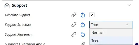

As Cura is mentioned in the question, it could be solved using Cura. The only organic support in Cura is called Tree as option of Support Structure in UltiMaker Cura's advanced options.
This option works best if you want support, but do not want Cura to build it on top of your end product (Support Placement -> Touching Buildplate).

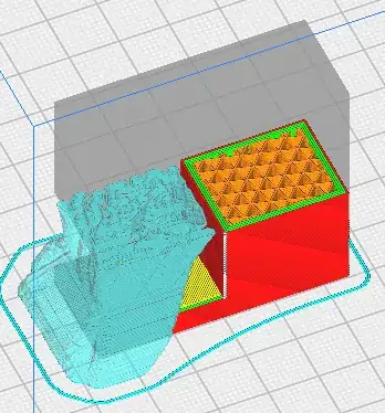

This would lead to the generation of an organic like structure for the support structure:
