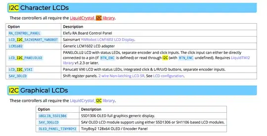

The Marlin configuration page, Configuring Marlin, shows two interesting tables for I2C displays:
I2C LED display tables
This is the LiquidCrystal I2C library that is referred to above each table.

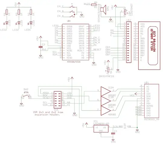

This blog, I2C Port Expander & LCD working with Marlin, actually has a working example of an I2C 2004 LCD. It also lists the changes required for configuration.h
However, unfortunately, it requires an additional DIY I2C port expander PCB, which employs a MCP23017, which is detailed here, I2C port expander driving an LCD screen, click encoder and more.
Schematic

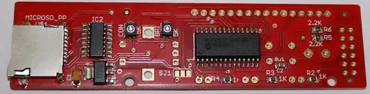

An example of the revised v2.1 PCB is shown in a subsequent blog, Panelolu2
Photo of PCB
This requirement of additional hardware maybe more that you had expected. However, you could just use a breadboard to make this interface board (port expander).
