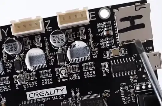

There are different versions of the 4.2.7 main board. This is an excellent video made by YouMakeTech:
To prevent the answer to become unusable due to link rot, a concise summary is shown below.

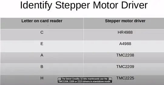

The correct drivers can be "read" from the written letter on the card reader: enter image description here

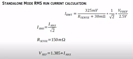

Depending on the driver, you need to find out what the maximum Vref for your stepper is (this depends on the maximum current rating of your stepper), e.g. for 2208, 2209 and 2225 drivers the Vref is calculated by the same equation: enter image description here

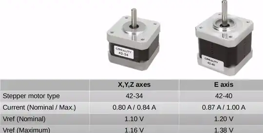

The Imax (maximum curretn) is depending on the used stepper: enter image description here
Use the nominal values to prevent the steppers to become too hot.

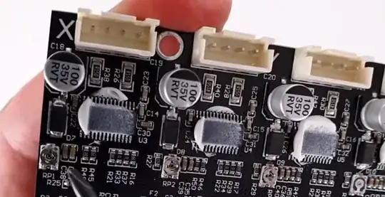

The Vref can be adjusted by the screw potentiometers next to the drivers, use a voltmeter while adjusting:
