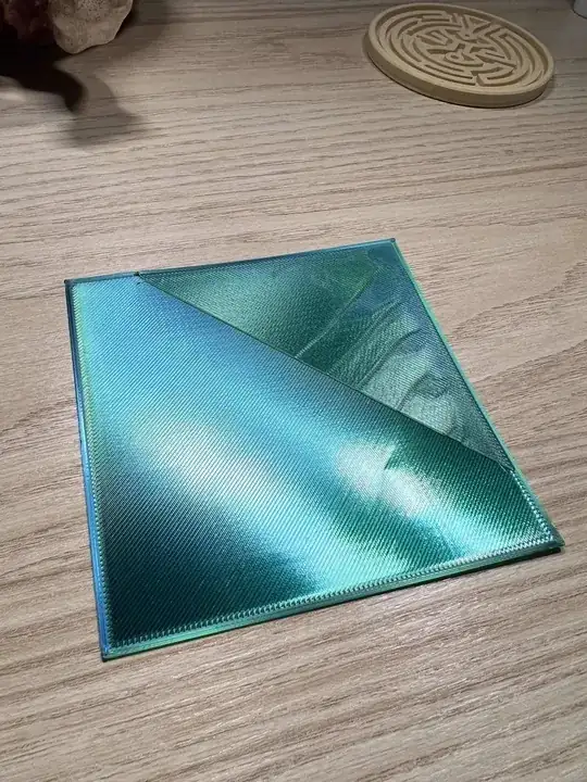

Photo of the first two layers of a printed model; the second layer looking very different

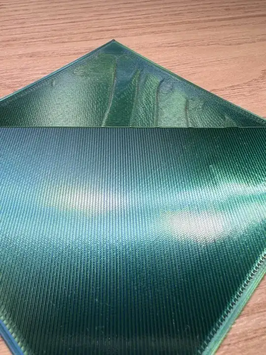

Upclose photo of the printed model showing the difference in the two layers

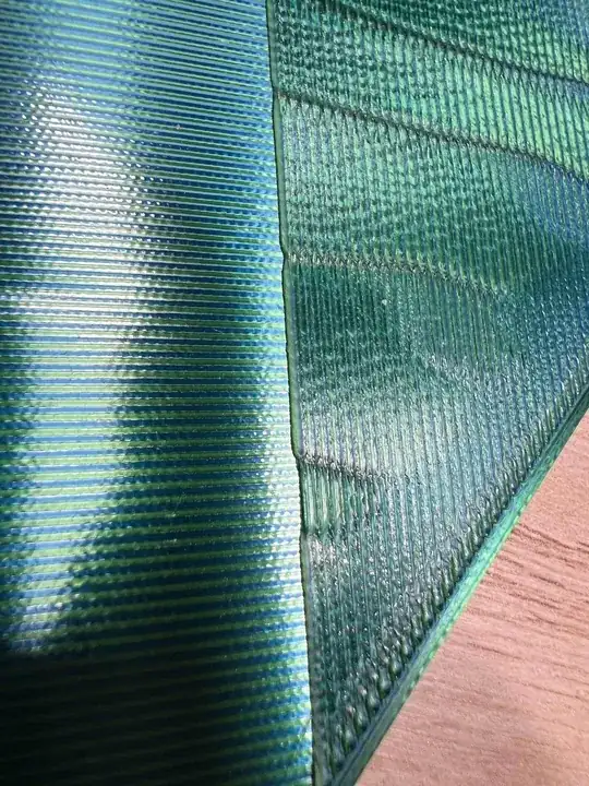

Zoomed in photo of the printed model showing the detailed differences in the two layers

I think it is overextrusion. I tried reprinting object. The first layer was perfect, but second was poor again. There was no difference with cooling or without, no difference printing slower. But flow rate did matter:

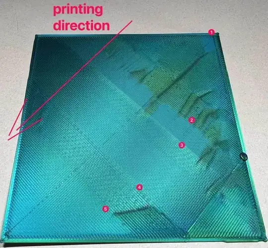

Difference of other flow rates

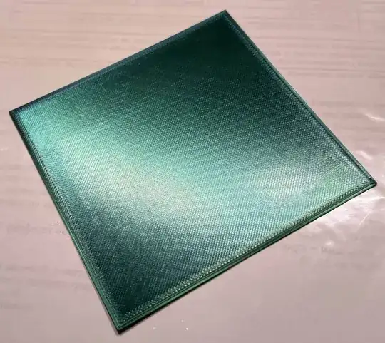

I think the answer is printing temperature. This shiny PLA I'm using is Eryone Silk PLA. Although the working temperature is stated as 190-220 °C, my 205 °C was too much for it. A temperature of 190-195 °C produces good results though not as shiny anymore. It is three layers printed on the sample below with no problems.
3D printed sample printed with 195 degrees Celsius and showing no printing errors
