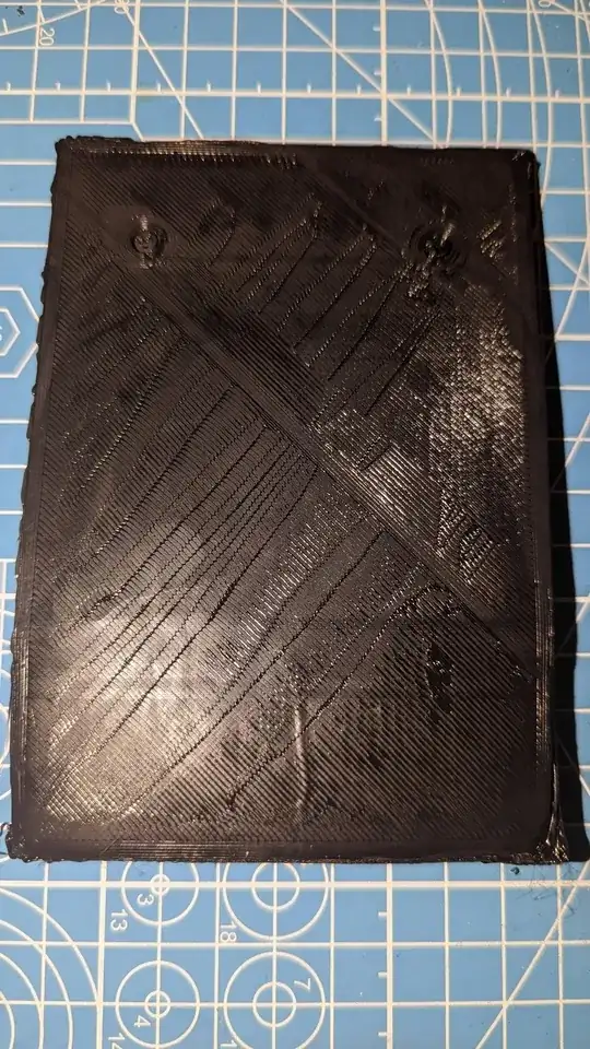

I was running my Ender 3 just fine with good first-layer adhesion/everything else but my setup changed after my Pi SD card got corrupted so I had to re-install and reconfigure my bed leveling via OctoPrint. After this my first layer started to look like this:
Image of 3D print first layer * this is the bottom of the completed print
IIRC I changed the following (and have tried undoing it but to no avail):
  • Increased extruder tension (since it was skipping while retracting)
  • Lowered z-probe offset (since re-calibrating it was too high)
This is with PLA
Running a modified Ender3 w/
  • BL Touch
  • Micro Swiss Direct Drive Extruder for Creality CR-10 / Ender 3 Printers
  • PEI Plate
  • BIGTREETECH SKR Mini E3 V1.2 Control Board w/ Marlin dev built 20210609
Sliced on Cura 4.11.0
  • Printing Temp: 210.0 °C
  • Bed Temp: 60 °C
  • First Layer printing speed: 20.0 mm/s
  • First layer acceleration: 500.0 mm/s^2
  • No first-layer fan (or any cooling at any point)
I've tried:
  • Increasing initial Z-offset; this doesn't work since it will affect my bed adhesion to the point the print will pop off
  • Adjusting extrusion gear tension; will start skipping on retraction/no-luck
After the first couple of imperfect layers get ironed over, the upper layers will not have any extrusion problems, or whatever this is, and are basically fine.

Solved, the nozzle was set too low and was causing pressure buildup at certain points since the PEI plate wasn't perfectly flat.
After raising it and swapping for a glass bed I was able to stop this behavior.
Note: While this helped this issue a little bit, it was also making adhesion really poor on faster prints. A better fix I found was that I recently swapped filament spools, it looks like the average spool thickness was greater than the previous one, and after reducing the flow 5 %. I was able to eliminate this problem entirely, thanks to the question What is causing 'droplets' on first layer?
