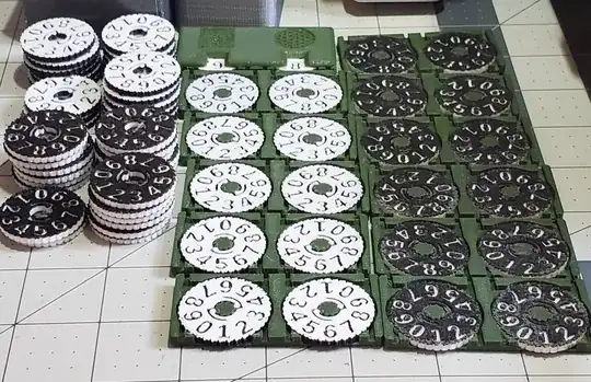

Manually pause and immediately do an X-home or Y-home so nozzle is not over the work. Swap filament. Repeat an X-home and a Y-home to assure printer knows where the nozzle is (it's possible to disturb the print head position while changing filament). Manually turn on extruder heater if it's off and allow to reach printing temperature. Advance filament to purge old color and assure heating chamber is filled. Resume.
It works pretty reliably for me...
Typical results...
