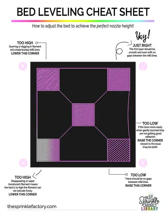

My personal way of keeping the Hornet bed leveled is manually instead of by firmware by having 5 individual files that each have a square at a different position (all the corners + center though I rarely use the latter) and when I notice prints start to look ugly on a certain corner I know I have to use that square to level.
The rule is: if you see spaces between each line, raise the bed. If you see roughness, lower the bed. You don't need to print the whole square either, just enough for you to see the filament fuses correctly as every line is being laid.
Levelling guide
(I understand this last point doesn't answer your question per se but I wanted to give you every option available to accomplish your levelling including manual)
