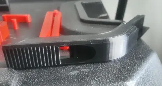

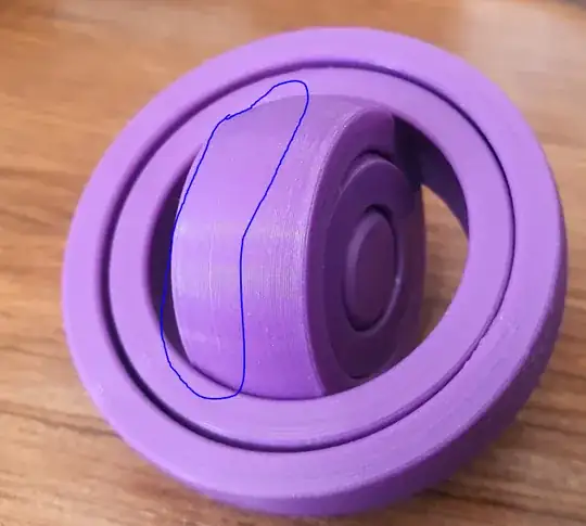

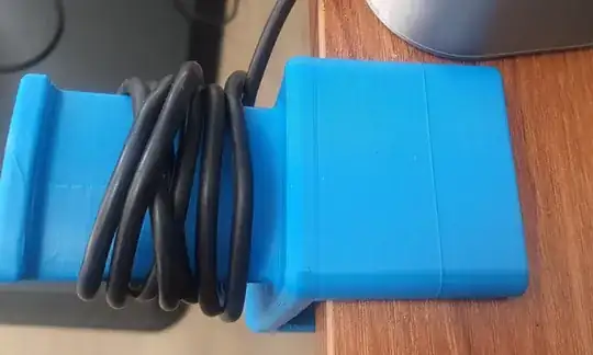

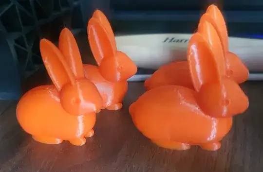

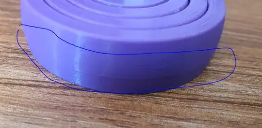

I have been having an issue for a while now with my 3D Print that one of the layers will appear thicker than the rest.
The line artifact will be on different height level. Also not all models that I would print would have this defect some will look pretty clean.
If I print the same model again the line will appear on the same spot. I tried with different filaments on the same model same thing again.
Is this maybe a slicer issue, anything that can help with finding the cause?
Printer CR-6 SE
  1. I have tried different retraction settings same result.
  2. I have calibrated the extruder and have changed the extruder to dual drive.
  3. I am using a Micro swiss hotend.
  4. Using 2.0 Cura 5.0 Profile from CHEP & CHEP 0.28 Fast Profile.
  5. Linear Advance has been calibrated.
Here is some images of models that came out with no line present.
