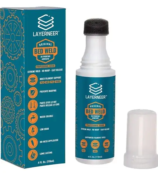

I agree with fred_dot_u, you are too far away from the bed. If you can't get it after that, I would suggest using Bed Weld by Layerneer.
Product photo of Bed Weld by Layerneer
