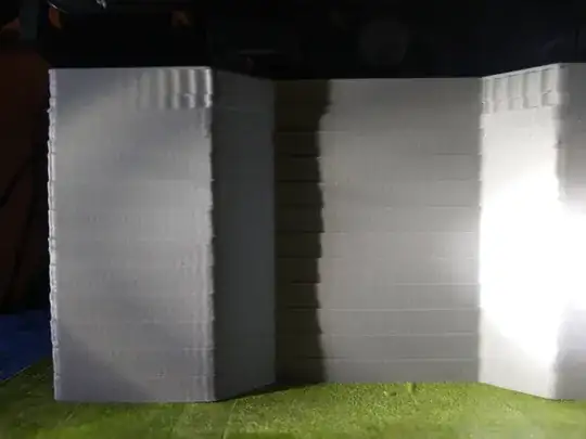

Here is a photo of the test print:
3D print of a Z-direction-extruded rectangle with a trapezoidal segment subtracted from the middle of the long side
The extrusion path was clockwise around the part (right to left on the side facing the camera and front of the printer/bed). Acceleration, scv, and input shaper settings were adjusted manually during the print to give different views of the ringing. The important detail is that there's almost no ringing in the middle flat section, except at the very top where input shaper was turned off completely.
No, at least not to the extent the above result suggests. I had the idea to try rotating the piece 180° around the Z axis, and got nearly the same effect: low ringing in the middle segment, strong ringing on the final segment. So what is the explanation?
The impulse intended to start the ringing for the middle segment is exactly opposite the impulse that ended the first segment, and generates a time-shifted ringing of opposite sign, cancelling out with the tail of the ringing from the previous impulse.
Overall, the ringing does seem to be somewhat stronger in this rotation, so I think my original hypothesis that there's an effect related to belt length or the idler is still plausible, but it's nowhere near as dominant as I thought.
