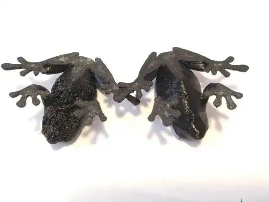

Lately I've been having a lot of trouble with printing overhangs in TPU. The failures are very geometry/toolpath dependent, entirely reproducible in their location (same gcode gives same failures each time it's printed), and seem to occur where there is a convex (model-inward) curve over an overhang of more than 40° or so. My original test case for this was frog model with more severe overhang, but I since made a simplified conical overhang test piece at only 50° that's faster to reprint and shows the issue:
Two upside-down 3D printed frogs
The frog print on the left is pretty much a complete failure. The one on the right is mostly a success, but shows some moderate flaws around one side (left, as viewed) and the front of the belly, and even slight flaws (hard to see in pic) around the other side of the belly. It was done using some of the mitigations described below.

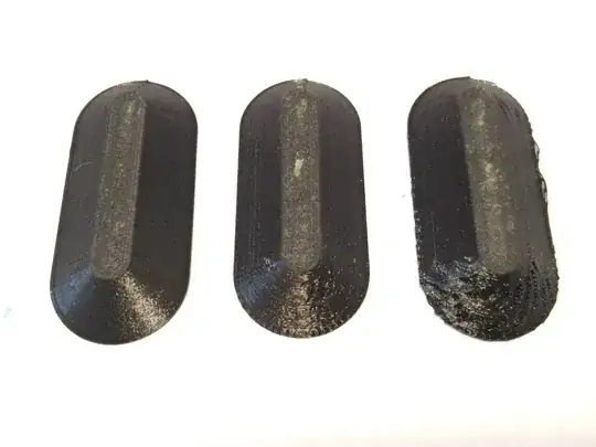

3 elongated conical test pieces - convex hull of two translations of a truncated cone with 8 mm diameter at bottom, rising 50°, turned upside down to show overhang print problems
The test piece on the left is nearly perfect. The other two show varying degrees of the overhang problem I'm experiencing, and make it easier to see what exactly is happening than with the frog. The extrusion seems to bunch up, then get stretched out too thin, in an oscillating pattern that builds up and shifts with each layer.
