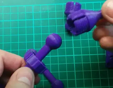

I am trying to create a two-piece snap-fit or joint using a 3D printer (Resin). After that, I plan to coat the joint with a conductive spray and create an electrical connection when the two pieces are joined together.
Has this been done before? Are certain types of joint mechanism recommended?
I will probably use carbon spray because it is cheaper than others. However, after the spray dries it can start to flake and thin, so I might need a couple of rounds of coating or something else. Any tips are appreciated.
However, more importantly is the joint mechanism - this is what I had in mind:
Plastic ball joint example
The signal would be a DC current only, in the µA range and the targeted resistance would be less than 20 Ω.
Can this work? If not, what are my alternatives?

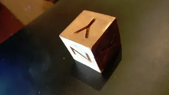

Electroforming is the process of applying a conductive paint to a non-conductive surface. Once dry, the object is subjected to a process similar to electroplating, in that molecules of a conductive, more durable metal are bonded to the conductive paint, which is bonded to the 3D printed part.
Typical metals would be nickel, which is quite conductive, as well as copper, known for conductivity. One could be somewhat absurd and perform the same process with silver and gold. The absurdity is related to the expense of those materials.
The link covers using copper, but I believe that nickel would be more durable.
Your joint selection is more related to the strength of the design and contact surface area and may be better suited for a more detailed separate question.
electroformed 3d printed calibration cube As usual, image from linked site.
