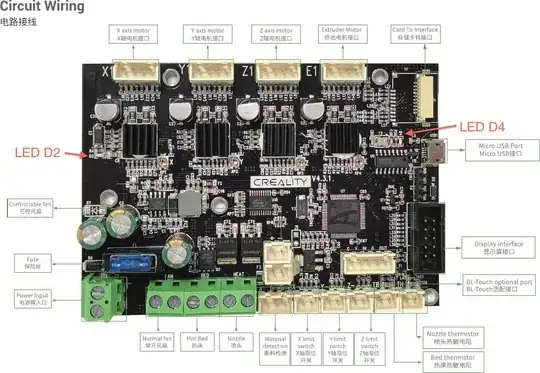

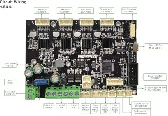

The user guide (on manualshelf.com) doesn't mention the LEDs at all. I flicked through all of it and the most useful page was page 29 which showed the motherboard but (again) there was no mention of the LEDs:
Ender 6 controller board
For reference, the LEDs at located thusly:
  • D2 is on the left hand side of the board to the left of the heatsink.
  • D4 is on the right hand side, just behind the USB socket
Ender 6 controller board (annotated)
FWIW, D2 seems to be red when powered on, as mentioned in this post and this post on My Creality Ender-6 is stuck at the boot screen with the white status bar.
