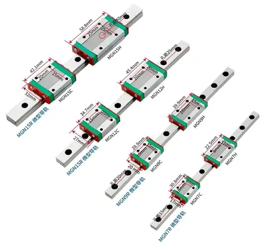

The final letter, i.e. C and H, refer to the length of the block, where C is the shorter version, whereas H denotes the longer elongated block which can distribute the load better (as it contains more bearings). These two lengths of the block can be seen compared, in the image below, which shows (from left to right) track widths of 15, 12, 9 and 7 mm, respectively:
Diagram of linear rails showing block length
Source
Note that there is an error in the diagram for the 7 mm rails - the lengths of the blocks (22.5 and 30.8 mm) have been, obviously, reversed.

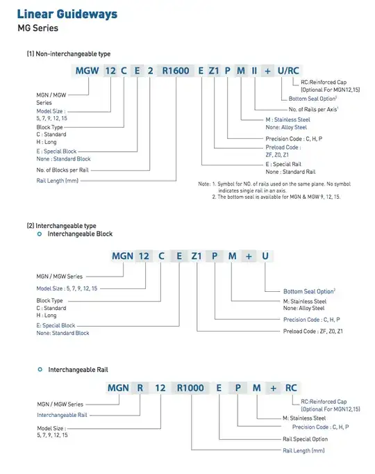

A detailed description of the product code is shown below:
Linear rail product code dissection
Source: Hiwin
