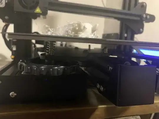

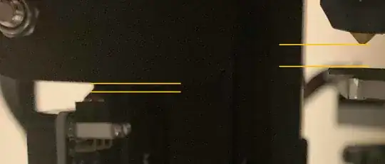

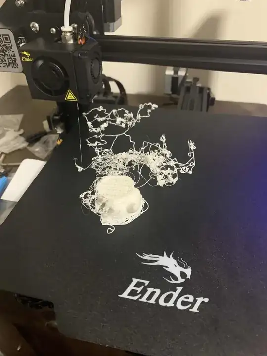

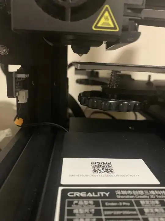

So I just got my first 3D printer the Ender 3 Pro. My nozzle is a bit too high (first image) and this is what happened after my first test print (second image).
I saved for a while to buy this and I’m really upset about this.
Photo of Ender 3 Pro nozzle well above the build plate
Photo of a model printed halfway through with 'spaghetti'
Photo of a model printed halfway through with 'spaghetti' but from the side

Your Z-endstop assembly is clearly too high. Referring to your own first foto you see that the switch on the Z-endstop mount is nearly touching the bottom of the X-Z mounting.

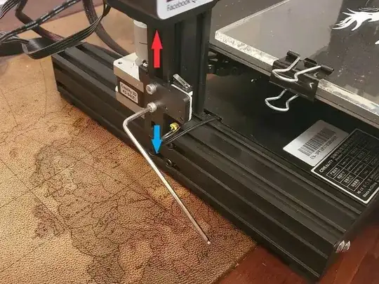

You need to adjust the whole mount by loosening the 2 hex key screws and lower the assembly (move in the direction of the blue arrow):
enter image description here Source: Larry Wood via All3DP
Before lowering the Z-endstop mount first screw in all the levelling/tramming screws under the build plate/heated bef a little and position the nozzle a little above the build plate; when the mount is fastened you can move the build plate up a little and tram the complete bed surface.
This All3D article describes the above in more detail, but the basics are covered above.
