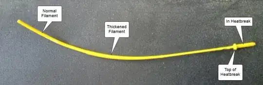

Disassembled hotend. Again, heatbreak and Bowden connections to heatsink would not give. Managed to manually feed filament whilst unscrewing heatbreak. The filament found is shown in the attached picture. The small thick bulge would seem to have occurred in the tiny area where the Bowden tube enters the feed throat of the heatbreak. The thin filament is stretching whilst trying to retract. After that can be seen where the filament has thickened again. Mangled filament trimmed and hotend reassembled making sure that the Bowden tube was seated in the heatbreak feed throat. Hotend to 200° and extruded 200mm filament. Tried a test print, not very good, but worked. Tried a second print, the problem was back again.

Filament from the Hotend
The lump at the top of the heatbreak is because there is a gap between your bowden tube and the heatbreak. Liquid filament is leaking out of the heatbreak and solidifying there. When you reassemble, you need to close this gap.
There should not be smoke coming out of your nozzle. Maybe when it is new, there might be a bit of oil that would smoke, but it should only do that once. If you are getting burned filament, your nozzle temperature is too high. Either the control system is overshooting and the temperature spikes, or your temperature sensor has a problem.
The thickened filament is worrisome. With the filament jammed at the heatbreak, if the filament is soft, it might be getting compressed. But PLA should not do this unless there is enough heat leaking into the bowden tube to soften it.

I too have been plagued with stuck filament in my hotend. First, I am using a ~300 mm long Bowden tube on a delta-type 3D printer. Every time it jams, I can pull the filament back out, I find the end having a slightly larger diameter that is ~2-3 mm in length. I cut this off and feed it back and I am good to go.
A couple of observations:
  • I replaced my Bowden tube and heatbreak, but I may need to taper the end of the Bowden tube so there will be 0 gaps with heatbreak. My Bowden tube I.D. may be too large and during retraction, it expands in the Bowden tube.
  • Next, the filament tolerance is +/-.03 mm. This may not be tight enough to cause it to get stuck.
  • Last, the temperature should be reduced to the lowest possible to prevent any heat to migrate up the heatbreak.

Worked out the reason for the thickening filament. A number of sites refer to heat creep and suggest that you check that the heatsink is clear and the heatsink fan is working properly. In my case, they were. However, the fan outlet (where it blows on the heat sink) was full of garbage. Cleaned that out things improved. Also replacing a dodgy thermistor cleared up the residual problem.
