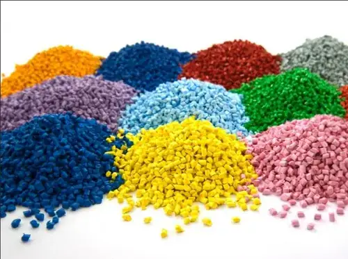

Yes these exist. 3D printers using pellets is not uncommon for industry, but for the user at home this might be a different question. Pellets are the pre-fabricate before it is extruded into filament (small balls/cylinders of plastic).
Random image showing a variety of pellets in different colors
There are even processes to turn used plastic into pellets, so if you combine it all this should be very doable. The problem is to get a consistent type of waste plastic to feed your machine. The size of the nozzle doesn't matter, as long as your shredding, compressing and heating process can keep up with the flow you need. It would be an excellent idea to get rid of plastic waste and turning these into building bricks e.g. for insulation of heat.

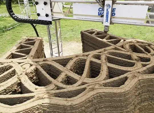

On a large scale, there are "3d printers" that can place a special quick-drying concrete and produce small buildings as homes in a matter of days. However they're fed a special mixture of smooth cement and accelerators to set the concrete ready for the next layer.
Tecla 3d printed house
