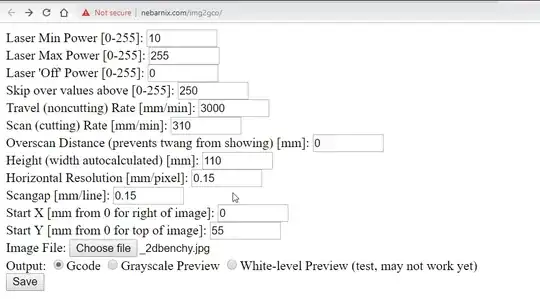

The website used to generate the G-code is http://nebarnix.com/img2gco/, and it takes a simple image file as input. The settings recommended by the video are as follows:
Generating the G-code for the laser
Note: As pointed out in the video, the minimum power should not be zero as this turns off the laser, thereby incurring a delay upon restart. Setting the power to a sufficiently low level - so as not to burn - is preferable, i.e. 10.
