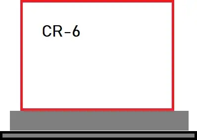

I have a Creality CR-6 SE running Community firmware. It's printing mostly well, in part because it's improvisationally enclosed (sheets of cardboard between it and the closes window to reduce draft, which was killing my prints on bad days). To make it moderately shock-resistant it's placed on a 50x50 cm concrete tile which is placed on 3 mm of foam. The foam reduces vibrations being redirected to the tile while the tile is heavy enough not to care either way.
CR-6, concrete tile, foam

First, let's get your physics straight:
No. The concrete tile gives your printer mass by adding its own to it. Mass by itself results in shifting the point resonance (and thus ringing) occurs, and in conjunction with a flexible mounting (the foam) results in the resonance window getting shifted out of the window where it can be problematic. Nothing about redirecting.
Now, to your problems:
Enclosure
If you want an enclosure, you can mount it directly onto the concrete tile, or you include the buffered concrete in the enclosure. Totally up to you. If you exhaust it, just adding a big PC fan to the back and then a flexible tube to the window to get rid of warmth if you need would be enough.
Dampener
3 mm is way too little. You should get at least one of those rubber mats from the home depot that is put under washing machines. Those thick rubber pads are usually 10 to 20 mm thick and would decouple the printer movement very well from steps on the floor. You might even want more of a different, softer foam between that rubber pad and the concrete tile.
