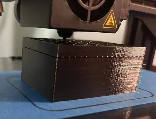

For some reason, my larger prints, or rather the ones that I create, have this "dotted" line in them. And, that line usually splits into two pieces.
I use Ultimaker Cura for a slicer, I use Blender for modeling, and I have an Ender 3 Pro
Let me know if anyone knows the reason for this as it's preventing me from making things on my own.

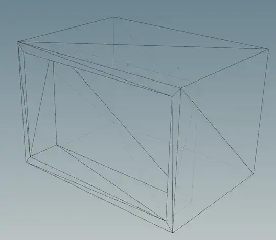

From your Cura file, I extacted the 3d model as a STL file, and it looks like this: enter image description here
Nothing wrong with it, it just a water tight triangulated mesh.
Cura produces a correct tool path, nothing remarkable there either.

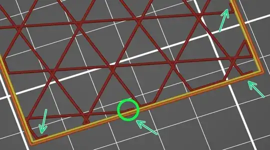

The red marks on both pictures indicate where the infill lines meet the perimeter walls.
You can also see that the part is already really close to delaminating mid print on lower layers (all of the yellow marks indicate places where it looks like that layer tried to peel but eventually didn't fail to the same extent.
You should try to optimize the settings of your slicer in the (filament temperature, print speed, layer height, cooling) space.
Prusa slicer has a feature related to infill sticking to walls, called Length of the infill anchor:
https://help.prusa3d.com/en/article/infill_42 enter image description here I didn't find a similar concept in Cura; maybe it could help for your setup, if nothing else works.
Also, you have elephant feet (bootom yello square bracket)
