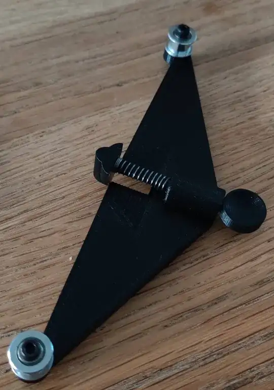

When I pluck the belts of my CoreXY printer, I feel significantly different tension between the two idlers on the back and the tension on the sides, between the gear on the stepper shaft and the idler on the back.
Is this normal? If not, what could be the cause?
For reference, I'm using this support for the idlers:

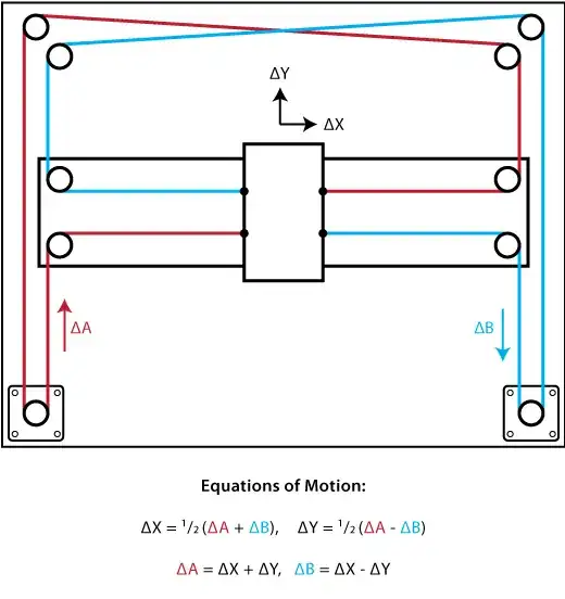

If you are referring to different belts, e.g. the top versus the bottom belt, for CoreXY machines, the tension in the two separate belts should be equal to allow equal force pulling the carriage. If uneven, this may lead to incorrect/skew prints or binding of linear bearings (from experience). A typical layout of the mechanism is shown below. Note that there are several solutions for placing the belts; they can be in the same plane (where the belts cross in the back, as depicted below) or have the belt each in their own plane (as in the HyperCube Evolution design as depicted in the image of the question).
CoreXY reference mechanism
Drawing published by Ilan E. Moyer, taken from http://corexy.com.

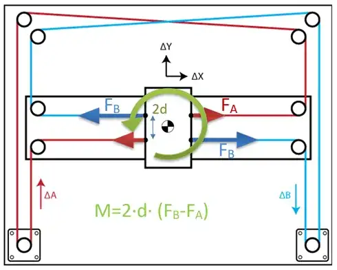

For both options, incorrect belt tension causes for different forces onto the the printhead carriage and result in a torque on the carriage (either in X-Y or in X-Z). E.g. a tight blue belt with a less tight red belt cause a resulting counter-clockwise torque on the carriage in the image below:
