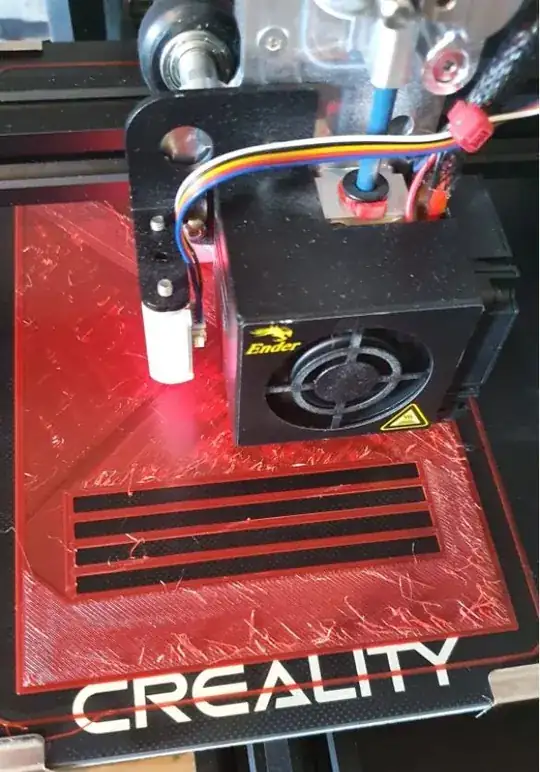

I'm getting a lot of blobbing and scuffing on top of my prints in PETG on my Ender 3 with AMH/DD. It doesn't seem to do this if the print doesn't have a flat bottom so much.
Mid-print model with blobbing/scuffing printing errors
I have the E-steps set to 130, which if anything is slightly under extruding vs the caliper measurements.
Any ideas how I can fix this?

Are you sure the 130 E-steps is correct for your extruder? You don't mention what extruder you're using, but presumably, it's something other than just moving the original extruder to a direct drive mounting position or that would be extreme over extrusion.
Assuming that's right, the most likely cause is having the nozzle too close to the bed, so that there's too little volume to fit the extruded material into.
Also, you almost surely need to increase your nozzle temperature a lot. I'd normally consider 235 °C the absolute minimum for PETG, and I can't get it to adhere properly below 245 °C with the stock Ender 3 hotend. Since you have an all-metal hotend you can go even higher. PETG likes to "scuff" like that when it's too cool, and when you travel over already-printed material, and the lowest layers are even more susceptible to it since the bed will be sinking a lot of heat out of the material as soon as it's laid down.
