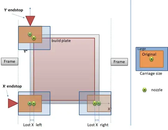

Bed dimensions
The following image reflects the changes to the build area when a larger sized carriage is used on the same printer (grey is the original size, red is the decreased area as a result of a larger carriage; note this is for fixed endstop positions!). Note, this is an example, CoreXY machines have limited space, so a decreased print area is more likely to be seen in both X and Y dimension. Prusa i3 style printers have the Y endstop generally on the bed carriage, so the bed size in Y will most likely not decrease. It totally depends on the construction of the printer, the extra space between the frame parts and the carriage (usually you can see that instantly by the endstop offsets, if there aren't homing endstop offsets, there is not extra space and the print dimension of that axis will decrease) or the ability to move the offset. Note that the bottom half of the image draws the out the result for losing X movement, the red area does account for losing Y movement as well, this is not uncommon for CoreXY, especially the printers with limited extra space for the carriage beyond the minimum and maximum bed positions.

From the TM constants we read that the endstops in fact define the origin of the printer to be at the endstops (the MIN values are zero) so the printer is at the origin when homed. Because of the larger extruder, already 8 mm of the X dimension is used, hence the smaller bed size of 306 - 8 = 352 mm. This is also the X_MAX_POS, the carriage is not allowed further. You should now look into your custom mount and the endstop location and deduce your own "x mm" offset.
