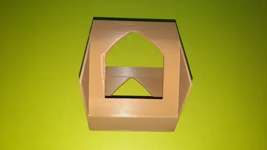

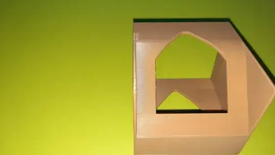

As you can see the left side of the edge came out jagged. The right side came out just fine. What happened to the left side?
I am using Ender 3 + BLTouch using Sunlu PLA+ with 200 °C hotend.
Left side
Right side

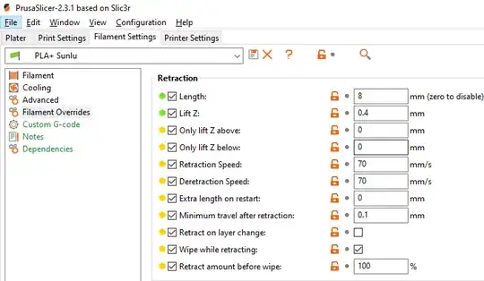

Here are my retraction settings (if that matters):
Retraction settings

This may be due to uneven cooling. The part cooling fan only comes from one direction on the Ender 3 series of printers. You may be able to solve the issue by printing the walls from the outside in. If not, I recommend printing a fan shroud that has part cooling ducts on both sides; there are plenty of them on thingiverse.
TreeBarkEater
  • 330
  • 15
This was happened because I don't use support on the slope. After I use support the jagged edge is gone.
