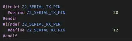

Search the source code for file "pins_MKS_GEN_L_V21.h" There should be E1_SERIAL_TX_PIN and E1_SERIAL_RX_PIN defined. Rename them to Z2_SERIAL_TX_PIN and Z2_SERIAL_RX_PIN.
driver uart pins

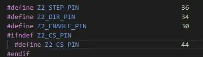

In "pins_RAMPS.h" file, find a block of a few lines that starts "E1_STEP_PIN", and rename E1 to Z2 for all those lines.
driver pins

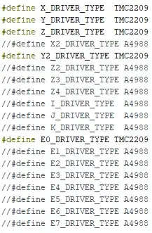

In configuration.h, make sure the DRIVER_TYPE axes are all set correctly to the number of drivers you actually have. For example, I am using a driver for X, Y, Z, Y2, and an extra one E0 (for pumping liquids), so 5 total. Here, Y2 will replace the E1 driver, so E1 is commented out. Therefore, all used drivers have the TMC2209 commented in here. Everything else should be commented out.
Screen shot of Marlin 2.0 Firmware, in Configuration.h section. Search for 'X_DRIVER_TYPE'
