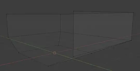

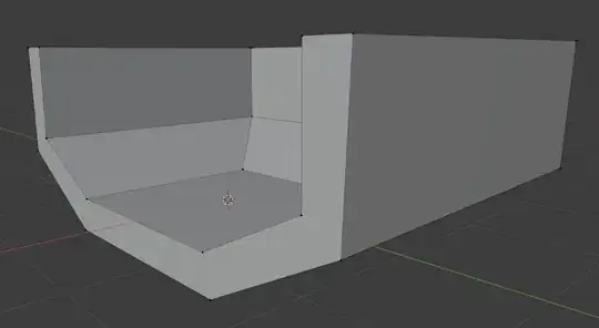

After stitching the model in any areas where you still have gaps, you remove any vertex belonging to areas you do not want to use for the mask. This leaves you with pretty much a skin-tight base for your mask. Select all the remaining surfaces and scale S them in all directions in regards to the origin so you create a little airgap 5% extra (1.05) should create enough space to sit somewhat comfortably, but you might prefer a little more. As a stand-in for the face, I use this approximation of a forehead...
Next, we thicken that surface using the modifier menu: Select the Solidify modifier and set a thickness that looks good to you and that might be printable. Then make sure it pushes away from where your face is. Also make sure the Offset is at 1 or -1 to ensure that it does not stick out from the face-scan surface to the back! enter image description here

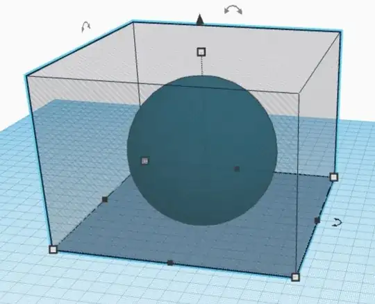

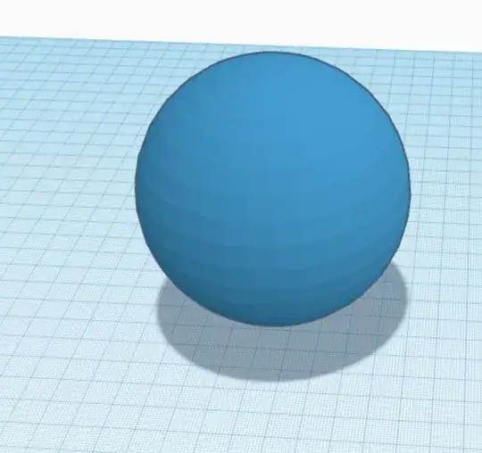

Step 1: Import your 3D model (imagine that the ball is a head):

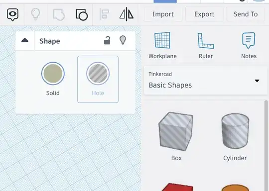

Step 2: Change its type from "Solid" to "Hole" enter image description here

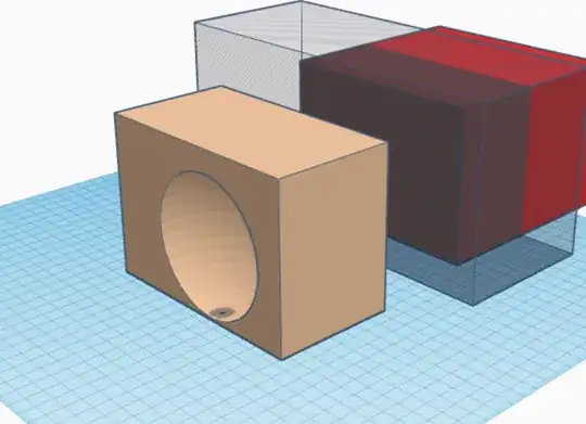

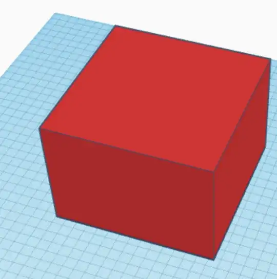

Here is the inverted Solid/Hole version: enter image description here

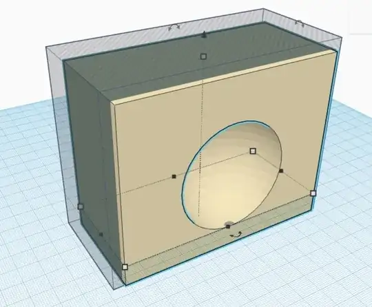

Here is the Solid version with the Hole model inside your Solid box: enter image description here

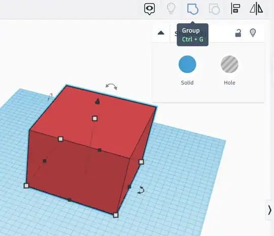

Step 4: Select both models and group them: enter image description here

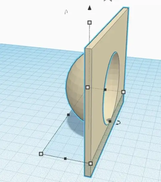

Step 5: Add a box covering half of your mold (ideally splitting it in half):

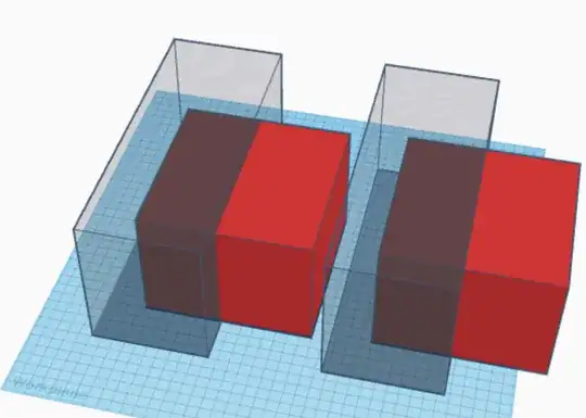

Step 6: Duplicate the mold and the box enter image description here
Step 7: Group the left mold with its surrounding box: enter image description here

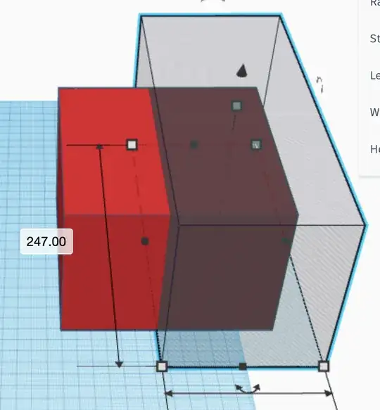

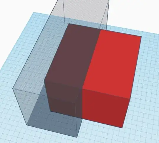

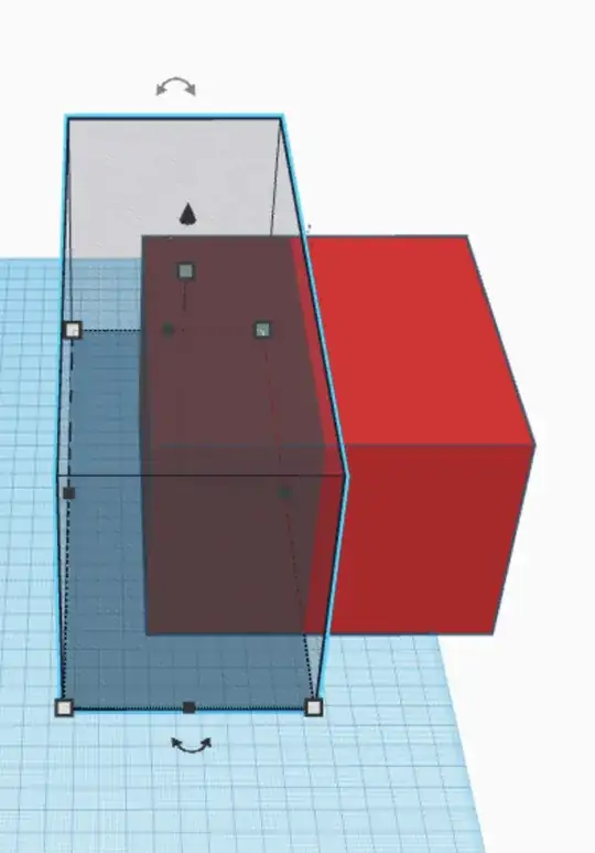

Step 8: Invert the box of the left mold by taking its left corner and dragging it over to the right side of the mold: enter image description here enter image description here

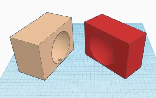

Step 10: You now have two molds for each half of your model: enter image description here

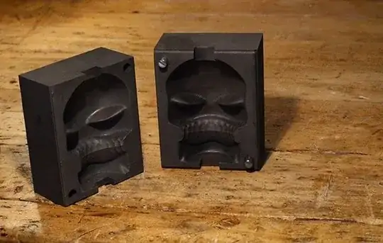

  2. You could also get a bit more creative with the joining of the two molds by adding channels or some kind of way that they can fit into each other with greater precision. Here is an example: mold.
