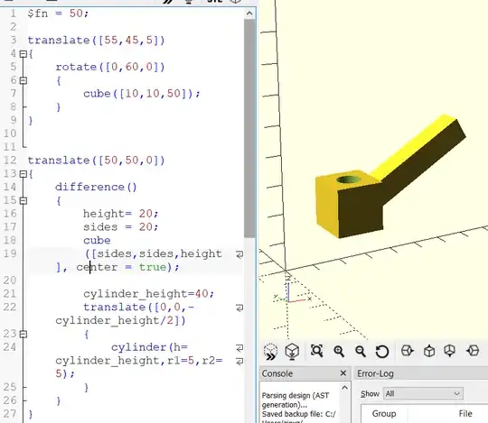

From trying out several alternatives (Fusion 360, Wings 3D, Blender, and others), the closest free offline equivalent to TinkerCAD turned out to be OpenSCAD.
It has nowhere near the same level of intuition, but based on info from two tutorials ("OpenSCAD Tutorial - Beginners Quickstart", "OpenSCAD - Model a Bearing in less than ten minutes."), OpenSCAD was able to fulfill the minimum requirements that were needed from TinkerCAD most quickly, i.e.,"...ability to create solid shapes and holes, and with resize, align and rotate options"
