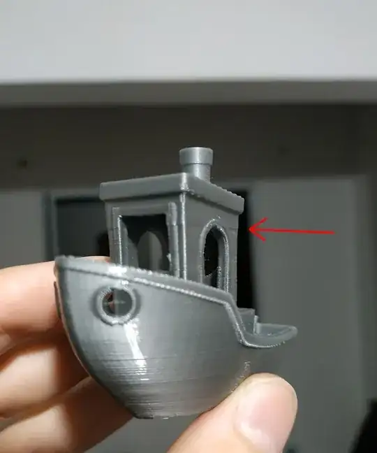

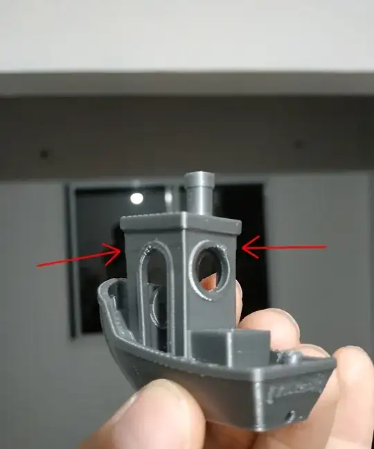

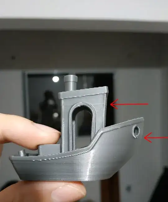

I have just acquired my first 3D printer, a BIQU B1. Overall I'm quite pleased with the printing results but I'm having minor defects on the Benchy test. I'm not sure what the problem is, but I guess it's related to the overhang and maybe vibrations.
My print settings are:
  • Software: Ultimaker Cura
  • Temp: 205 °C
  • Heatbed temp: 60 °C
  • Height: 0.2 mm
  • Print speed: 60 mm/s
  • Travel speed: 150 mm/s
  • Flow: 94 %
Imperfections in Benchy - front
Imperfections in Benchy - rear
Imperfections in Benchy - side

From the Benchys, it is apparent that the temperature is quite high or that there is not enough part cooling flow. This can be seen from the sagging of unsupported overhanging structures. Considering the bow of the Benchy is quite fine, the most probable cause is the temperature, usually with too less part cooling flow, the bow shows defects.
Please note that a Benchy is a gimmick that does show defects, but it isn't a calibration object, there are many other different test prints available.

After two weeks of working on different settings in different slicers, I finally have a profile which has improved the quality of my printings. It still has some overhangs, which I'm sure will improve by increasing the cooling flow like 0scar already mentioned.
Here is the profile bundle (for Prusa Slicer): Link or see this answer below.

I agree with this answer. There might be an obstruction in the cooling. I also have a B1, have you checked the included printed part that redirects the blower fans towards the part and made sure it's clear? Mine came with some warping that I had to file off.
