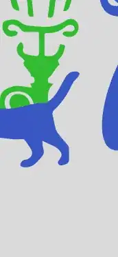

This is an example of the print, the very first layer:
Print 1: 0,4 mm layer of blue
Print 2: 0,4 mm layer of green
Print 3: Much thicker and bigger print of white filament that prints around the previous prints during the first 2 layers and start covering all by the third layer.
Imagine a box cover with a drawing on top. The first layers of each print must be as smooth and nice as possible as is it the visible one. I was doing this manually before installing the BLTouch with very good results, the drawing gets embedded in the final printing.
