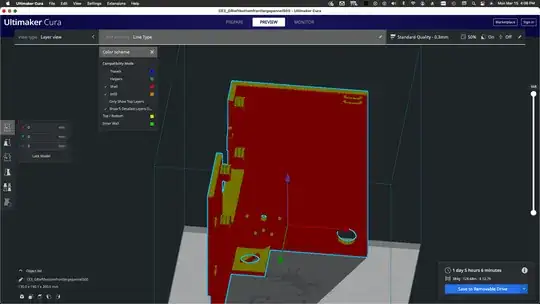

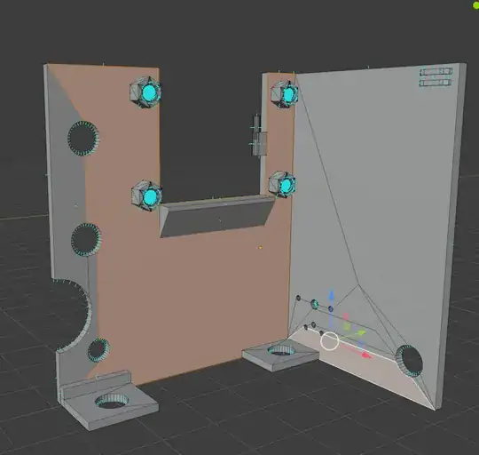

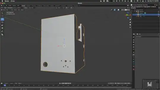

I'm using Cura and it removes my holes and deletes sections of the print and disconnects parts. In Blender it looks as it should be, as I designed it. I know there are a few mishaps inside (not manifold) but is there a way to fill in everything on the inside. I only care about the externally facing faces. This is extremely infuriating I hope someone can tell me how to force Cura to print what is originally seen in the .stl.

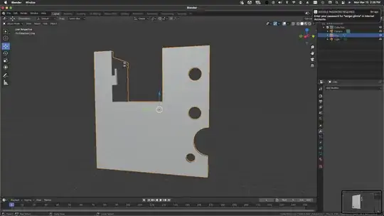

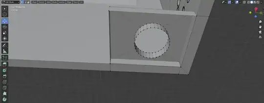

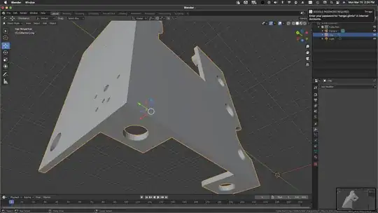

Blender as it should look
Again how I designed it.
These are photos of how it should look.

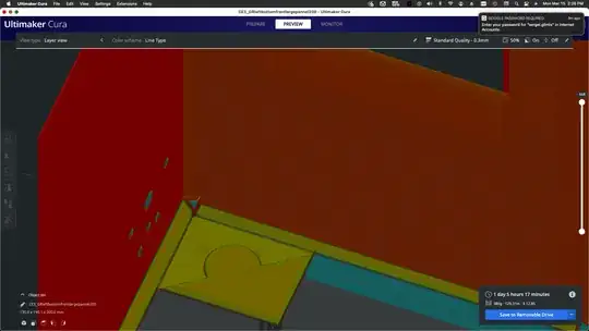

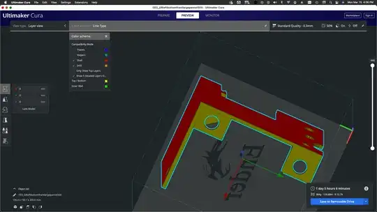

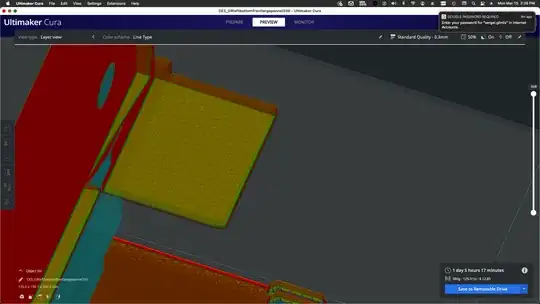

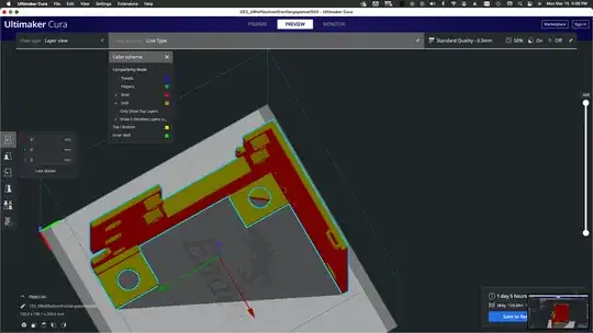

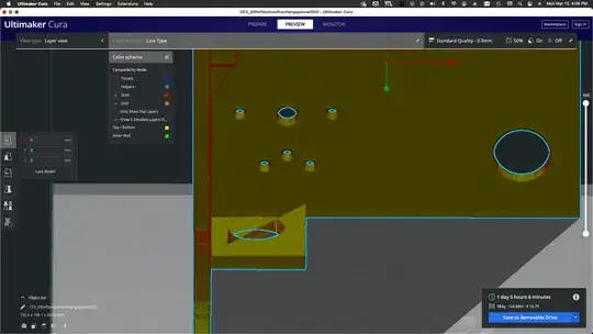

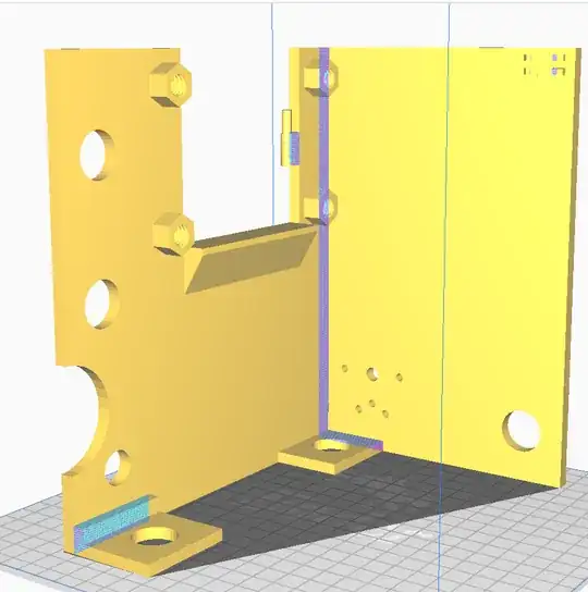

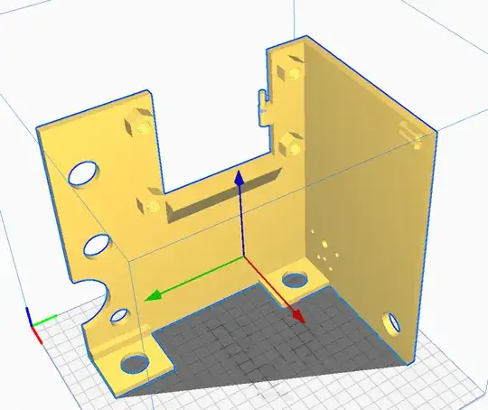

Now these next photos are how Cura previews it. Not only does it fill in the holes (no, fill holes isn't enabled) it adds huge gaps in the side and bottom of the print as can be seen.
All messed up.
How can I force Cura to print what I see in blender in the original .stl?

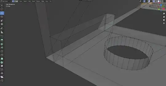

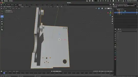

I am exporting in Blender to .stl and opening that in Cura.
I was able to fix it partially by fixing normals in Blender but there is still this:

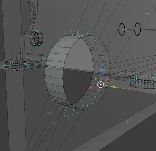

But are you sure they are truly externally facing? Turn on normals in Blender and ensure that all the arrows/pointers are external.

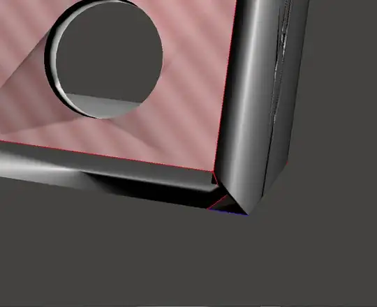

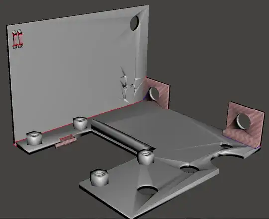

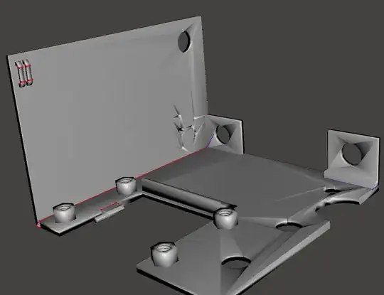

With the STL in hand, I opened it in Meshmixer (free) and immediately was given a clue.
STL image in meshmixer
The zebra-stripes are reversed normals.
Here's another error point, difficult to see clearly in flat 2D image, but panning and zooming and orbiting and all those 3D manipulating things shows there's nothing there:
broken corner
The other end of this not-joined area shows a bit better:
other broken corner
After selecting all I could find/locate, I did the reverse normals and here's a slightly improved result:
corrected part
Unfortunately, the other borked up portions prevented meshmixer from performing a suitable auto-repair, completely destroying the model in the process.
Those joint corners and any other colored lines have to be addressed individually.

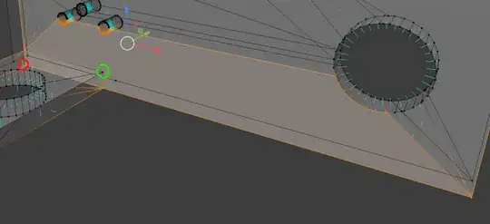

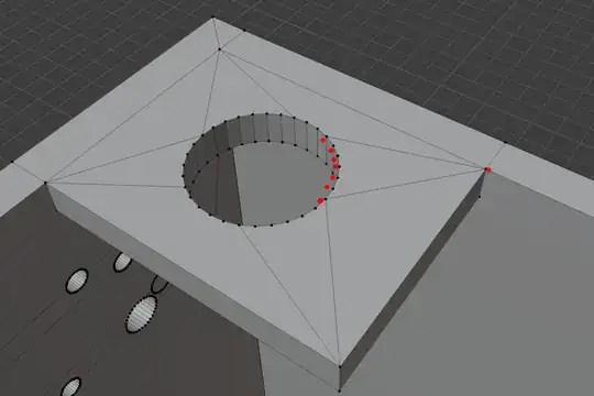

Step 1: add missing surfaces.
Select the vertices around the hole that has no bottom surface and then pres F to create a surface. Use several steps, making roughly triangle surfaces. For example: select the red marked vertices, then F and then the next set.
![enter image description here

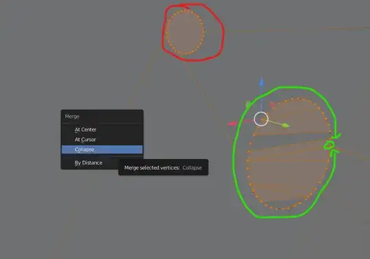

Step 3: Superflous surface geometry
Some areas have remnants from areas where you worked. Merge those vertices to prevent new artifacts from cropping up. Select the vertices, M and then collapse for each circle, like the red one. Some might need to be collapsed at a specific vertex to prevent surfaces from getting ripped or intersecting badly - in the lower picture the green circled one.

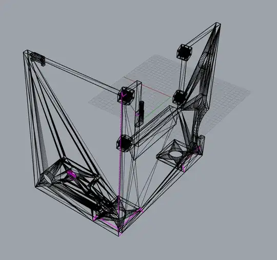

Rhino gives the following output for MeshRepair
  • Mesh has 3 degenerate faces. (a face that's actually a line or a point)
  • Mesh has 42 non manifold edges. (a line where 3 or more faces meet, possibly caused by degenerate faces)
  • Mesh has 6 duplicate faces. (faces that share the same coordinates)
  • Mesh has 148 naked edges (edges that have only one face)
All of these things are indicators that it might be difficult to distinguish inside from outside.
Naked edges
I have encountered these problems after changing a model a lot during it's lifetime (adding/removing stuff). Since there are 200 errors and it's a relatively simple model, I advice you to fix these kind of problems by starting with a new clean model, using some of the coordinates of the old model as reference.
Also: be sure to check out blender's 3d printing wiki, they seem to have quite some tools similar to rhino's meshrepair

Okay, so like suggested I put it into 3D Builder (A free Windows 3D modeling program). I imported it as an stl, then exported it as an stl and imported that stl into Cura. And lo and behold all problems were gone! If you are having a similar issue give that a try! The 3D Builder program and similar ones are designed to export for the sole purpose of 3D printing so it automatically fixes these issues! If this doesn't work try editing yours in edit mode (Blender) a bit so it makes it easier for 3D Builder to fix it.
