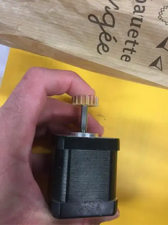

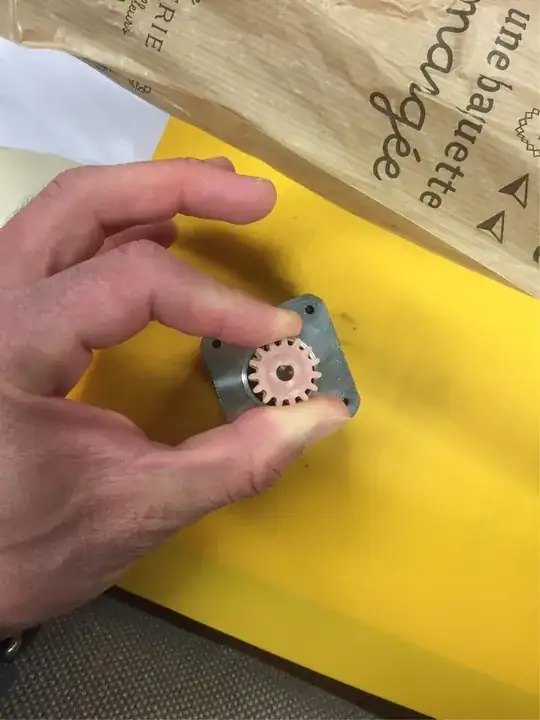

I uploaded a 3D object for this project to Fusion 360 and printed it out straightforward:
Yet its middle hole is too small for the stepper motor (Nema 17 Stepper-M) I am using so I wanted to increase its tolerance before reprinting it.

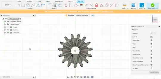

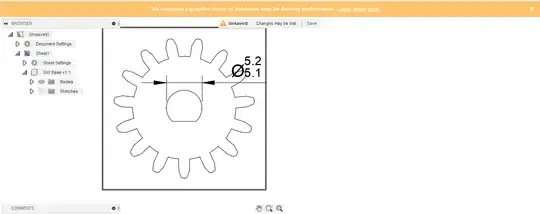

So, I followed the tutorial by Tyler Beck of Tech who lead me to drawings:
I was wondering if doing a drawing (sketch in Fusion 360) was sufficient to expect the shaft of the step motor to go through?
Here are the gear and the shaft before I add the drawing constraints:

This seems like a tolerance press fit problem and similar to what you will find if you try the same using normal machining operations on a lathe or milling machine.
I print 3 mm clearance fit holes on my Prusa MK3S, meant to fit on 3.00 mm (measured with a digital caliper) stainless steel shafts. The printed parts are from Fusion 360 models, with 3 mm holes by design, converted to STL and then sliced and printed with 0.2 mm layer height. The holes are very close to 3.0 mm and out by 0.05-0.1 mm.

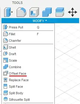

The solution was to make adjustments in Fusion. I left the model with the hole size as 3 mm but then use the Offset Face command on the inside of the extruded hole to make it slightly larger with the required tolerance.
In my case, an offset of 0.05 provided a nice press fit, and 0.1 offset allowed the shaft to closely fit in the hole but loose enough to rotate.
I suggest you create a simple model with a number of holes designed to be the same size and then use different Offset Face numbers to dial in what you need. That way you get to learn what to expect from your printer and its accuracy.
