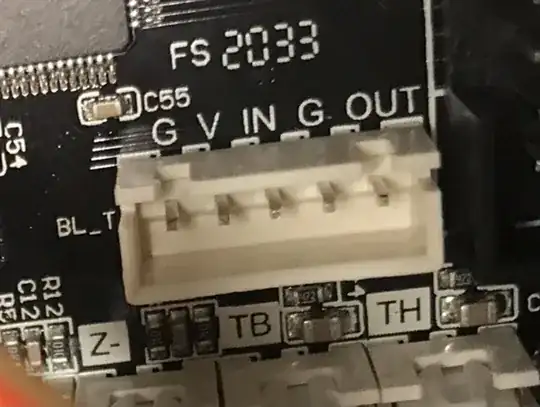

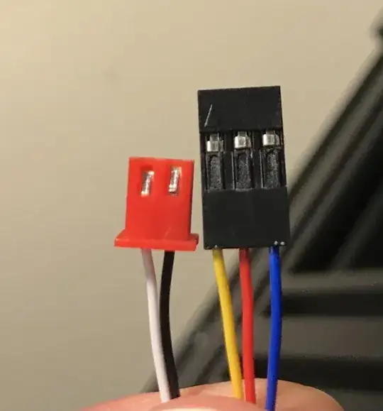

I'm using 3D4LYF's wiring scheme as I'm using the same set up I believe he is using. The two wires (white & black) on the red connector go in the Z-axis endstop port on the mainboard. For the three wires on the black connector I have: blue=Ground, red=V, yellow=IN that goes in the other 5 pin port on the mainboard. I rearranged the wiring from red/blue/yellow to blue/red/yellow as suggested by 3D4LYF again because I am using the BLTouch Creality Kit. Adding photos of 5-pin port and the connectors:

Resolved : connected the white & black wires to the 5 pin output on the board. This solved the homing issue.

I had the same issue and thought I bricked it, so thank you for getting me on the right path! For Ender 3 Pro v4.2.2 motherboard, no Pinboard A, ISP Pinboard, or Burner required! In my case, I had used the provided pins (white housing) that were on the v4.2.2 motherboard itself.
In doing so I had to switch the positions of the red and blue wires in the 3-pin connector (glad I pay attention to those types of things), connected white and black connectors right beside it as the OP has figured out (the connector my BLTouch came with was a little big so I had to cut a wall of the white housing a little; it fits really well), and re-connected the original Z-axis cable (did not need to remove to start with, but still unused as the BLT pretty much replaces it).

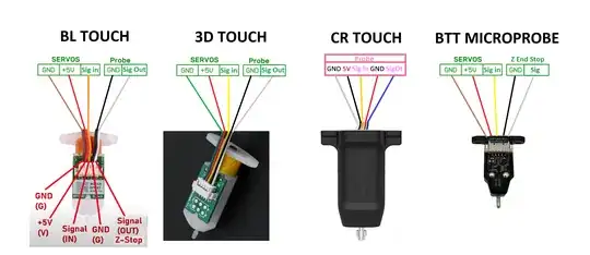

Never use a color code because Creality does change wire colors but in this case:
  • Blue - Gnd
  • Red - 5 V
  • Yellow - Sig in
  • Black - Gnd
  • White - Sig out.
No matter what Touch is used, the pin order is always the same unless you use a BTT Mini OFC.
Graphic showing the BLTouch, 3DTouch, CRTouch, and BTT Microprobe along with their corresponding pinouts and wire color coding
