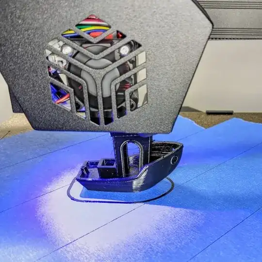

I replaced the hotend with parts bought from AliExpress.
My printer is now able to reach/maintain temperature and complete prints successfully (no more heating failure).
BTW: It's harder to buy replacement parts for CR-6 (as compared to other Creality printers). There were only 2 type of replacement hotend parts for sale on AliExpress at the time I was shopping:
  • 40 USD for a full assembly (with carriage)
  • 28 USD for a nozzle kit.
There's an Amazon seller and a Canadian 3D printer store that sells individual parts, e.g.: heater block, but the prices are relatively expensive.
I bought a full assembly, but a nozzle kit would have worked as well.
Also, it looks like they're fixing their production process; my new hotend assembly was built better, even with what appear to be the same parts.
Not pretty, but at least it's printing - Hopefully this is it.
test print
