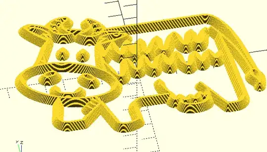

buildPyramidalExtrude(4,2.5,20) import(file = "Farm/cow.svg", center = true);
result
Oneira
  • 211

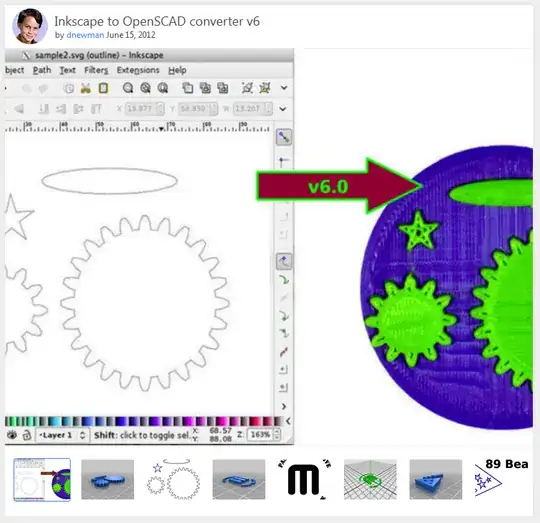

Late to the question, but I'm working on a similar project as the question presents. My solution is to open the SVG file in Inkscape (version < 1.x) and use the Path to OpenSCAD extension to create a set of points for each entity.
The extension generates paths based on the desired extrusion height and places each set of points in its own module. In so doing, one can scale each individual entity and manipulate each one as desired.
Inkscape Extension for OpenSCAD use
Image from linked site.
