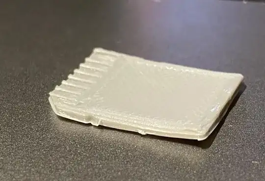

enter image description hereEnder 5 Pro prints are very uneven on base of the model.
In this example I printed an SD card dummy but it is not even flat.
Having a glass bed it is super strange to see this kind of behaviour.
Here are parameters in Cura.

Thanks in advance, I tried quite a few calibrations but nothing helped so far.
This is a classic example of not enough adhesion. Tune bed temperature (usually hotter), use a brim or add an adhesive layer like glue stick or hair spray or a dedicated print adhesion spray.
The question "Warping of bottom of print" has an accepted answer that explains in detail how and why this occurs.
