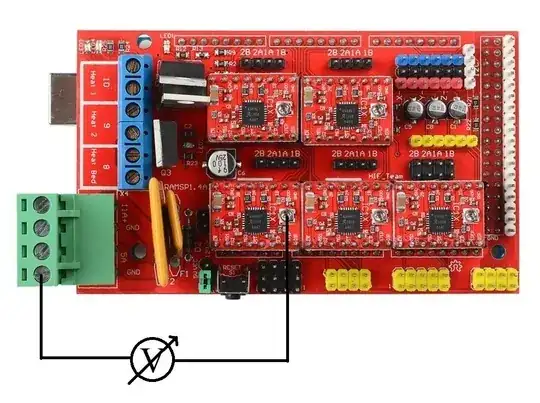

  1. Set your multimeter to volts, range can be autorange or something bigger than 2V.
  2. Connect one lead of your multimeter to the ground of your Prusa i3 controller board's power input (I use the screw that fastens the ground input of the RAMPS). The other lead goes directly to the center of the trimpot on the Stepstick. I took the best of my paint skills to create an image showing the process: measure Vref scheme
  3. Note the value you read (12V power has to be on)
  4. Use an insulated screwdriver and turn the trimpot slightly.
  5. Get a new reading by repeating the measurement process.
  6. Repeat the whole process until you get the desired Vref.
Warning: While I've had no problems turning the trimpot while everything was switched on (with my DRV8825 drivers), you should switch the power supply off when doing so.

You measure voltage between potentiometer and GND (see on the picture)
