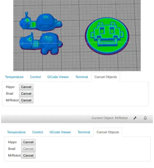

In addition to the previously answered "Exclude Region" plugin for OctoPrint, the "Cancel Object" plugin for OctoPrint also works excellently.
Cancel single objects during a print based on code comment lines
This plugin allows the user to cancel single objects during a print while allowing the remaining objects to print normally. Instructions for use with compatible slicers are provided on the plugin’s GitHub Homepage.
Cancel object plugin screenshot in OctoPrint
Source: OctoPrint-Cancelobject
