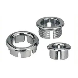

In addition to the aforementioned enriched filaments which give an excellent result, ABS can be plastered, painted and even chrome plated.
ABS plastered, painted and chrome plated
