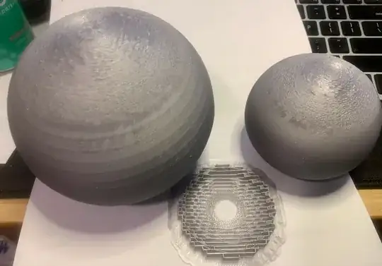

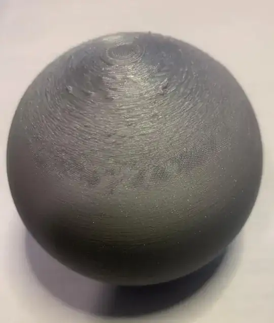

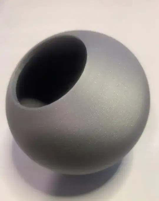

I have a model of an eye that I custom made in Blender 2.83 that when printed only creates roughness on the printed object near where I had the supports. The supports are not the cause of the roughness (at least not completely) since the supports don't even touch the parts of the print where the majority of the roughness and bumps are (refer to my photos of the print)
The roughness is only near the bottom part of the sphere as it prints upwards (refer to photos)
What I'm looking for is a technique or any suggestions for printing this without the roughness so it's smooth like in the rest of the print. I'm also curious what is causing the roughness.

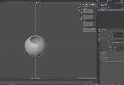

Eye Model in Blender
Eye model in blender

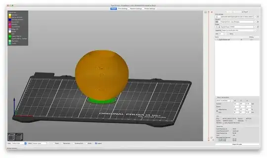

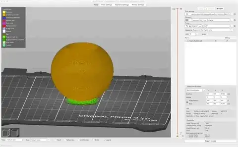

Eye Model in Prusa Slicer
Layer Gif

Eye Model Small & Large Version With Support (Notice roughness on the sphere)

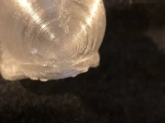

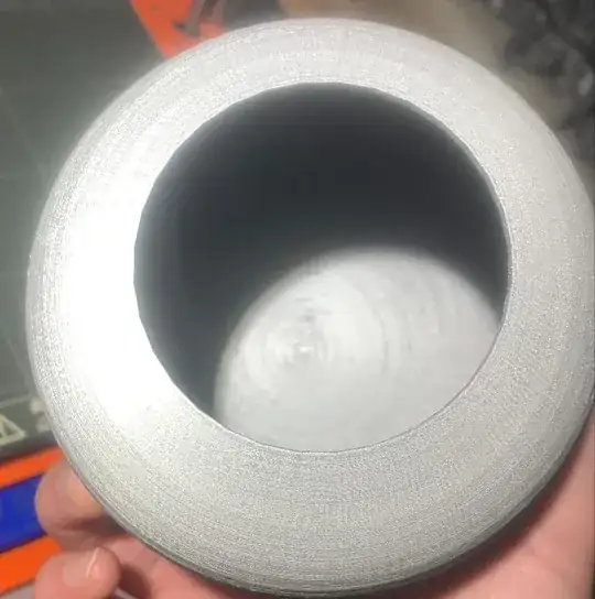

Smooth on inside of print
Smooth on Inside

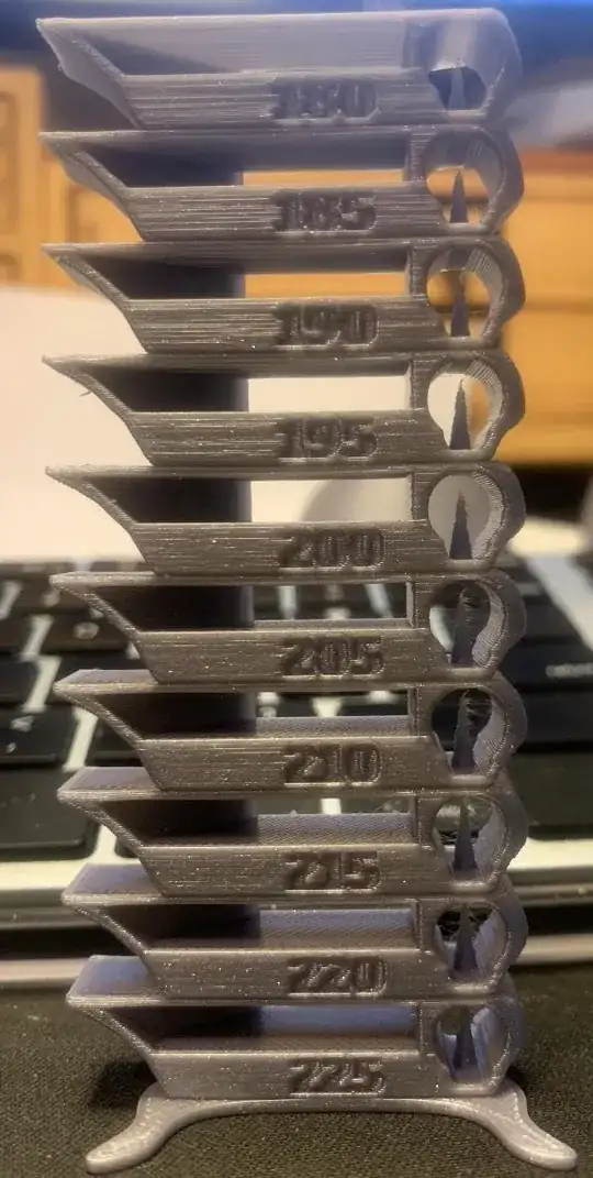

Notes: The suggested temperature for the filament is 205-215, I've adjusted after careful calibration given my environment to a lower temperature to reduce stringing. I created a tower at different temperatures and discovered 190 was the perfect setting to reduce stringing in my case with this material. Refer to my screenshot below. I do not think temperature has anything to do with this since the print is smooth inside and near the top without any issues.
Temperature Tower Test For Filament Photo:
(Note stringing in the cone test areas at 225 to 205)
Temperature Tower

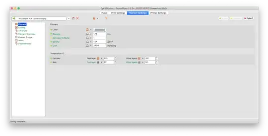

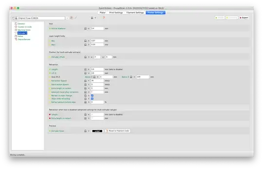

Filament settings
filament settings
Extruder Settings
extruder settings

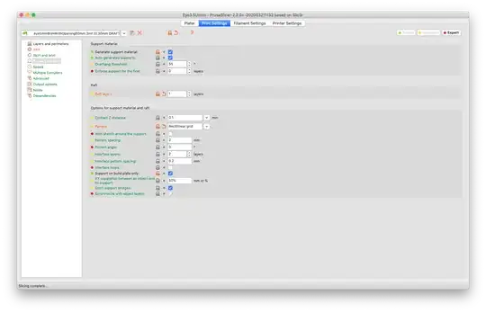

Support Settings
Support Settings

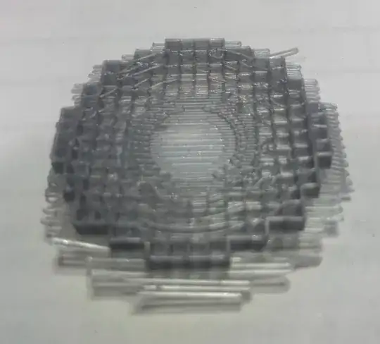

While Trish is completely right that the roughness can't be completely eliminated (you can't print a perfect spherical surface with discrete layers), the situation can be improved dramatically. The most telling photo in your question is the one of the removed support structure.
The part of your sphere that's seriously rough is all severe overhang. In this region, the outer wall of layer N+1 barely overlaps the outer wall of layer N, if at all, and without support would be printed mostly or entirely over thin air, failing to attach to anything and sagging/curling down randomly according to tensions in the extruded material, air currents, etc.
Now, with support material that's not entirely the case. Every so often (looks like a 2 mm grid) there are support lines under the overhanging outer wall. These will anchor it every so often and keep it from curling or sagging too much, but they don't actually constrain it to the place the slicer wanted the wall to go, and they don't provide a surface for the extruded material to press against to get the desired (e.g. 0.4 mm wide by 0.1 mm thick) extrusion cross section; instead the cross section will tend to be circular as a result of tensions within the molten material.
In order to get a decent surface over support material, you need what slicers call "Support Interface" or "Support Roof" (these are the names Cura uses; I suspect it's similar in Prusa Slicer). This feature builds a top surface as part of the support material itself for the supported part of the model to rest upon and press against. Of course that can make support harder (potentially a lot harder) to remove, and depends on tuning the Z distance between the model and the support as a tradeoff between quality and difficulty of removal, but it should get you much better results.

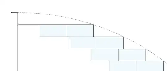

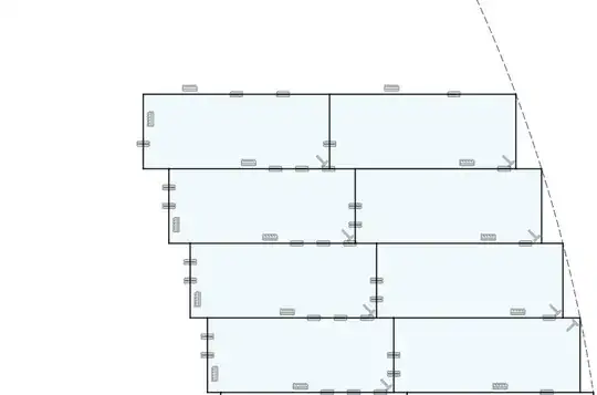

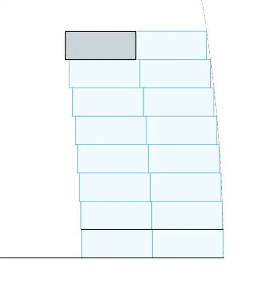

Let's look at why it is rough: the roughness is from the layer height and the thickness of the perimeters (walls). At some point, perimeters of the given thickness have to be placed in a way that does not cover up fully anymore. Let's look at this example of stacking. At first, how looks a sphere close to the equator? well, the stacking is rather easy there. Think of each printed wall as a rectangular crossection and you get this pattern:
As we move further up along the print, the overlap between each subsequent layer gets less and less. Somewhere in the middle we are at this situation:
Till at the top of the dome this happens: The steps appear coarser and coarser and in the end create a very visible and feelable stepping pattern. Also, the top layer might get skipped because it is not a full layer height, depending on the slicer settings..

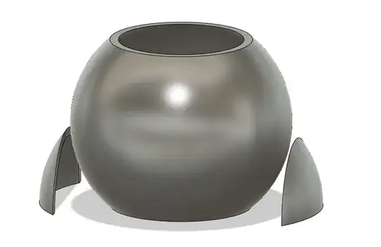

  • Cut up your sphere. An example cut up is here, but there are other options. If your print orientation is not mandatory, you can even cut your sphere up and reorient it to achieve this, mitigating both the layer problem as well as making support use 0:
