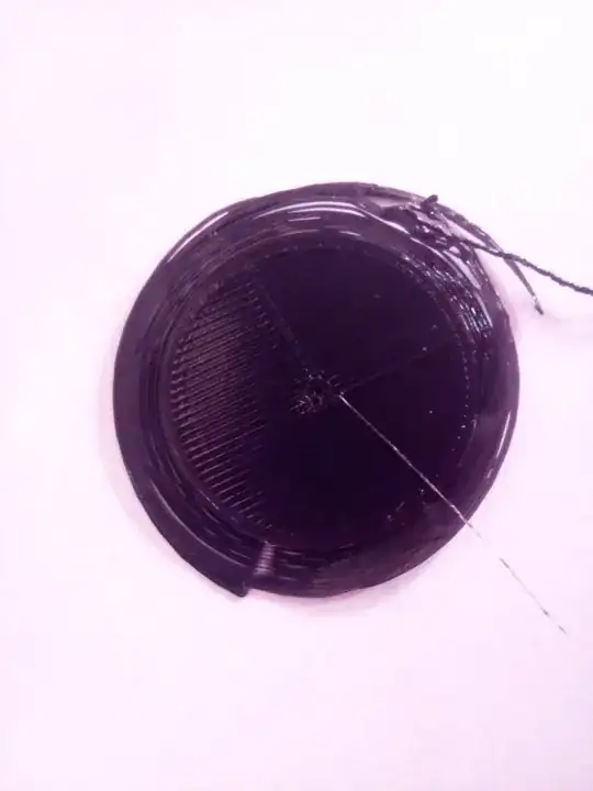

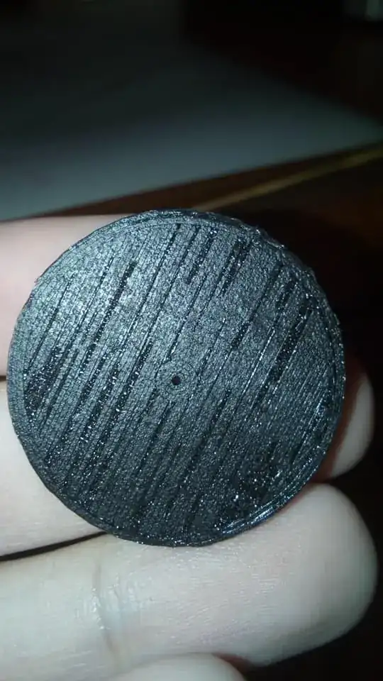

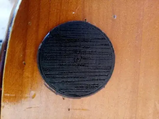

I'm newbie at this stackexchange and I have a "FlashForge Finder"; lately there are many problems with the horizontal surfaces quality (Bottom and Top at the same time).

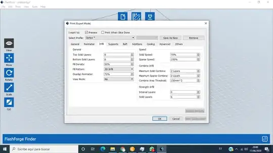

As some issue guides suggests, I changed: number of solid layers, % of filling and extrusion multiplier; I use "Flashprint", so some concepts must be translated from Cura in the options menu.
P.S: All filaments are PLA.
Without any change: enter image description here enter image description here
After all changes (the "best") enter image description here

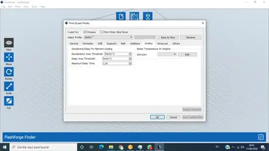

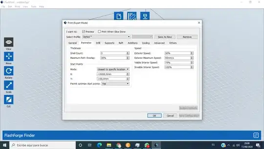

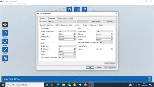

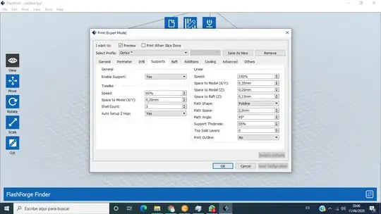

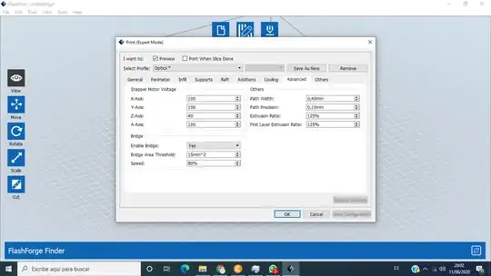

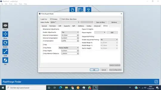

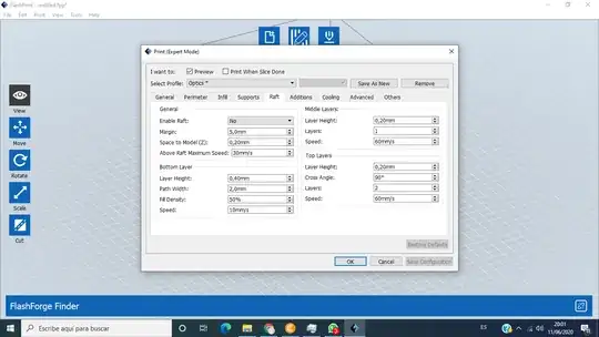

My settings for last black disk: enter image description here enter image description here enter image description here enter image description here enter image description here enter image description here enter image description here enter image description here enter image description here

This could be caused by under extrusion, often caused by the bed being too close to the hot end / extruder nozzle. You could try to relevel the bed, or change the screws so that the bed moves down slightly. Often when levelling, you want to feel slight resistance when sliding a piece of paper between the bed an the nozzle. You should do this for all 4 corners. Be careful though, you dont want the bed too far away from the nozzle, or problems maybe arise with the print not sticking to the bed.
Hope this helps, Luke.

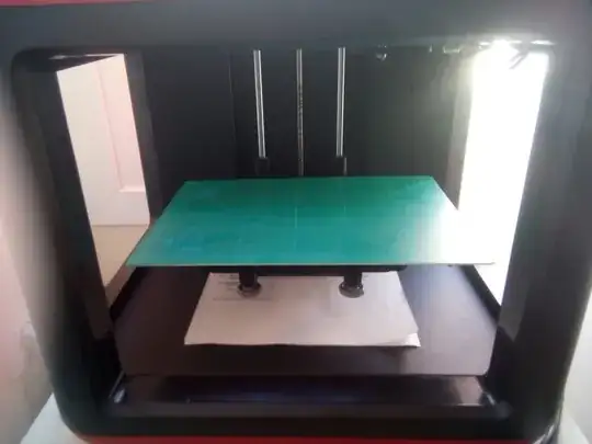

-When the bed is too close from the hotend:
I cheat the machine with a cutter patterns board over the bed at the first extruder calibration; the distance increases several times and then You can do it shorter. enter image description here

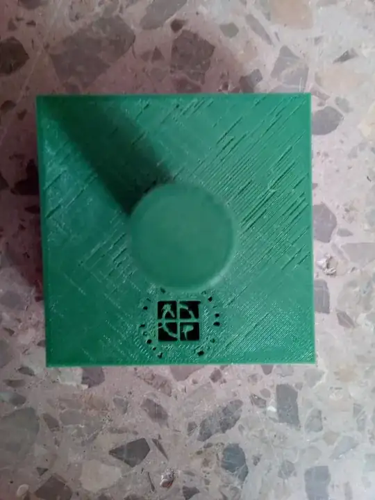

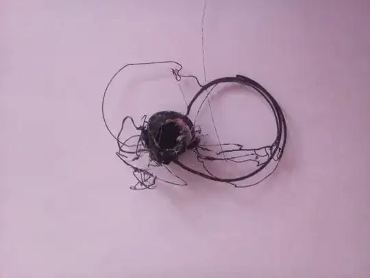

-The another half part of bad quality [low maintenance of the hotend]:
As a good newbie, I didn't know the periods of maintenance and the hotend had much plastic waste the PTFE tube welded and burned at internal, so the only option was to replace it for another same or to upgrade to "All Metal"; I chosen to upgrade with the replacement and I'll more maintenance to this zone.
First attempt of trial piece: enter image description here ...PANIC!
But then and FINALLY! enter image description here Almost all correct, I can continue with my printings.
THANKS SO MUCH TO ALL, for your apportations and patience.
