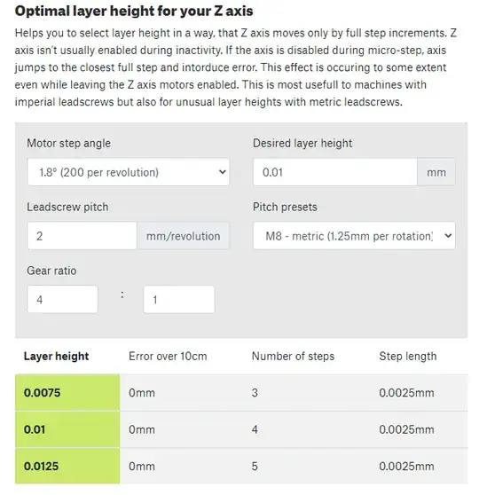

My calibration at my printer is okay. When I try to move 10 mm, it's exactly 10 mm.
But I want to know what is my precision for Z-axis.
(not posting the link of the product maybe it's not okay for the platform)
Spec for leadscrew:
  • Lead screw diameter: 8 mm
  • Screw pitch: 2 mm
  • Lead of thread: 8 mm
calculator page
My question; is my gear ratio 4:1 or 1:4? It's giving different results.

Your lead screw nut advances 8 mm every complete rotation of 200 full steps, so a single full step would change the height by 8/200 = 0.04 mm. This implies you need to set the layer height a multiple of 0.04 mm.
The gear ratio of 4:1 (a reduction) is required to get to your desired 0.01 mm layer height, but that is a very uncommon and a too small layer height to use.
