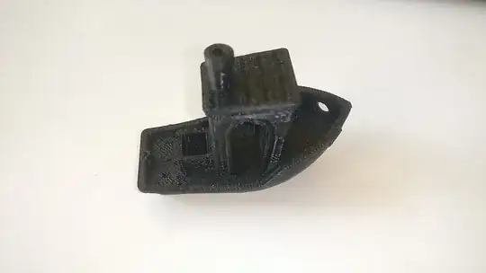

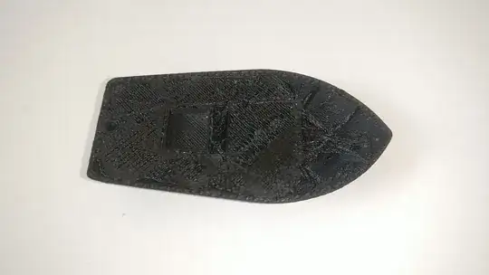

Here are images of 2 of the benchy's I printed. I stopped one of them half way through. The other one was my first print and the print speed was way too fast. I also did another print with slower settings but I can't find that one right now (that one was kinda stringy). A failed benchy I printed
My first benchy (the print speed was a little too fast)

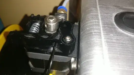

The printer is using one of those extruders where the fillament is fed into a tube leading to the nozzle.
The round thingey seems to be turning but it doesn't seem to grip the fillament well enough.

Note that a Benchy is a nice, well known print, it actually isn't a good example to calibrate the printer; it is preferred to print calibration cubes, preferably the ones with embossed X, Y and Z.
Under extrusion is usually a result of incorrect hardware/firmware setup or a slicer error. It can also be blockage, but then the extruder needs to skip filament once in a while.
The prints show severe under extrusion. Note that 50 (in the slicer, extrusion rate) means 50 %, this should be 100 %. Basically, you tell the printer that it may only use half the amount of filament it needs to print the object. Furthermore, when you command 100 mm to be extruded, the actual displacement of filament also need to be 100 mm. See "How do I calibrate the extruder of my printer?".
If you really commanded an extrusion of 50 mm (e.g. G1 F250 E50, first reset the length with G92 E0), the amount of filament that is extruded should be exactly 50 mm. If the extruded length is incorrect, the steps/mm in your firmware is incorrect. You can look them up (or change them) with G-code M92.
Please measure your filament diameter at several positions and if it is consistently different from 1.75 mm update the value in your slicer with the mean value.
A very common mistake for people using Cura for the first time is that the Cura default filament diameter is 2.85 mm, not 1.75 mm. But, if you commanded the extrusion yourself with a G-code, it should exactly extrude that amount. If that works, but your print still are under extruded, look into your slicer options.
