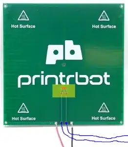

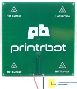

I just recently upgraded my Printrbot Simple Metal with a heated bed (and longer x-axis). I looked up some tutorials, and all of them placed the thermistor as in the picture on the left below, so I did too. However, the design of the heat plate seems to strongly suggest thermistor placement as in the picture on the right, inside the small hole near the center.
I can certainly see the upside of that. The reported temperature may overshoot the average bed temperature (the reasoning used in the tutorials I read), but most of my prints are built in the center of the bed, and the center placement would surely make the temperature control system more responsive.
What are the pros and cons of these placements? And what would be the proper technique for putting the sensor in the center? Should I still use kapton tape? Do I need to make sure the thermistor makes physical contact with the aluminum of the print bed?

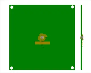

Depending on thermistor type you can get values from around 1ohm/C to 0.01ohm/C so placing it on particulat place on heatbed (HB) could be very important. If objects are placed in the center then it's quite obwious that thermistor should be placed also in the middle.
Another issue in terms of thermistors are the wires. Because thermistors can be so sensitive then wires should have as less influence as possible on its temperature capacity. That's why wires and thermistor legs are so thin. Generally thiner than regular element's legs.
Answering your question - I would say it's better to put thermistor in the center hole, to use thermal grease in the hole so thermistor would have contact with HB. And personally I would use special thin wires to connect thermistor to the board. Kapton tape is then usefull to position thermistor head in the hole and in the thermal grease. Have a look on the picture.
I have such configuration. (In fact I got additional insulation as mentioned in this thread).
I would not recommend to use circuit board tracks as a thermistor connectors at all, but it's my opinion of course.
[edit]
Please be careful - thermal grease can be electrical conductor or insulator. You should choose insulator because short circuit thermistor legs will cause measuring impossible.
[edit2]
As you know HB is not even necessary when you print PLA so in this case it can be even better to not have heating at all than to overheat the bed. Because if you put your thermistor near to the edge of HB then (as said by Leo Ervin) the difference can be at level of 20C so if you heat around 70C and you get 90C your model can become soft on the bed surface and it will loose dimensions or you'll get elephant foot.
As stated in the comments - it's not really big deal whether you measure the temperature in the center of somewhere around. The issue is what level of perfection is ok for you.

It doesn't make a great deal of difference where you place the thermistor; do whatever is most convenient for you. The temperature of the heated bed is not very critical, and some inaccuracy in the measurement is perfectly fine. The point is to keep the print from cooling down too fast, and whether the bed is at 95C or 93C makes little difference.
The pros and cons of thermistor placement are exactly as you describe: in either case the center of the bed will be hotter than the edges. Placing the thermistor in the center the temperature of the center will equal the setpoint, while the edges are cooler than the setpoint. Placing the thermistor at the edge the edge will be at the setpoint while the center will be hotter than the setpoint. Placing the sensor at the center you would need to use a slightly lower setpoint to get the same result compared to having the sensor at the edge.
It is possible the holes in the PCB are meant for if the PCB is used with a different printer. In any case, soldering the thermistor to the pads and placing it in the hole is acceptable, kapton tape wouldn't be required then (but can't hurt either). It would be best if the thermistor made good contact with the heated bed surface, using (non-conductive!) thermal paste would be convenient for this (but not strictly required).
