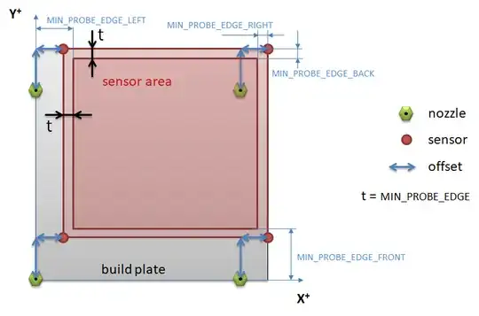

From these excerpts it is clear that the bed limits are incorrectly defined.
Following the theory from this answer the probe is only allowed to visit the following (dark red) area:
Probe area for back-right probe Marlin 2.0.x
This area is defined as:
  #define MIN_PROBE_EDGE_LEFT (PROBE_OFFSET_X_FROM_EXTRUDER + MIN_PROBE_EDGE)
  #define MIN_PROBE_EDGE_RIGHT (MIN_PROBE_EDGE)
  #define MIN_PROBE_EDGE_FRONT (PROBE_OFFSET_Y_FROM_EXTRUDER + MIN_PROBE_EDGE)
  #define MIN_PROBE_EDGE_BACK (MIN_PROBE_EDGE)
which translates to:
  #define MIN_PROBE_EDGE_LEFT (25 + MIN_PROBE_EDGE)
  #define MIN_PROBE_EDGE_FRONT (55 + MIN_PROBE_EDGE)
As seen in the commented //#define MIN_PROBE_EDGE_LEFT 5 and uncommented #define MIN_PROBE_EDGE_LEFT MIN_PROBE_EDGE (equals 10) left probe limits, you are at least respectively 20  or 15 mm short, hence the sensor is not on the plate on the left.
