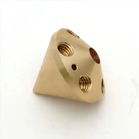

I discovered "diamond" nozzles (name of the design, not the use of diamond material), which have multiple filament inputs (designs for 3 or 5) and a single output nozzle, see figure.
Diamond nozzle, 3-in 1-out
They look like a very good and compact solution to avoid or significantly reduce purge towers, where filament is wasted until the channel is primed, and to avoid a second hot end, which takes space and which could be oozing when unused, but I could find them only made of brass.
Are there hardened diamond nozzles, or equivalent systems which are lightweight and can avoid a second hot end, to print composite or abrasive materials?

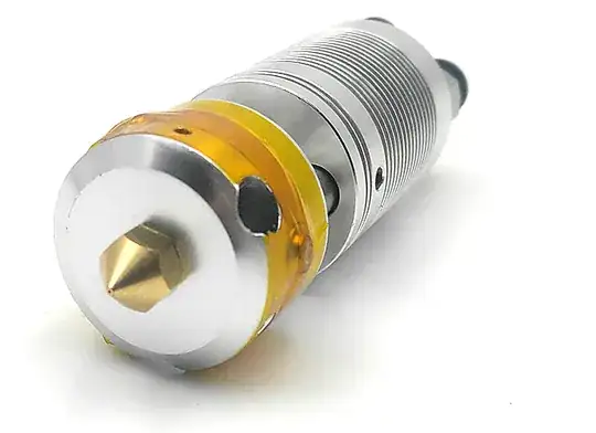

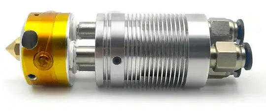

Yes, but there is no hardened version of the "Diamond" nozzle design. Basically when you want to use a hardened nozzle, or a Ruby nozzle in combination with color mixing (I specifically refer to mixing solutions as the melting chamber is smaller than filament changing solutions and your request for none or minimal purging towers) you need to order a design that accommodates the replacement of the nozzle. In such a case you can remove the standard nozzle to replace it for a hardened version.
There are a few 2 and 3 filament input designs that are offered on typical auction and Chinese selling sites. Below is an example for the Zonestar M3 mixing color hotend with a replaceable nozzle.
Zonestar M3 mixing color hotend side view Zonestar M3 mixing color hotend front view
