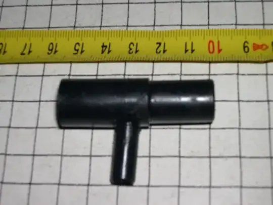

I've got an old car for which I have a small plastic piece who is broken. As it's an old car and a very specific piece, I can't find it anymore. So I was thinking about 3D printing it.
My problem is this piece is on the carburetor, so close to the engine. This means, it can heat a lot, close to 90-100 °C.
My question
Do the pieces created with the common 3D printing techniques melt at 100 °C? If yes, what kind of other 3D printing technique can I use?
Here is the piece I want to recreate (sorry for the bad quality), the scale is in cm. The piece

The number you're looking for is the glass transition temperature (the lowest temperature at which the material can flow or warp), not the melting point. This depends on what material you're using; approximate temperatures for common printable materials are:
  • PLA: 60˚C
  • PETG, high-temperature PLA: 95 ˚C
  • ABS: 105˚C
  • Nylon: typically 70˚C or above ("Nylon" is a large family of similar polymers)
  • Polycarbonate: 145˚C
Any plastic under your hood is probably either nylon (for its durability, impact resistance, and chemical resistance) or ABS (for its strength and heat resistance). These are both difficult materials to print: ABS emits toxic fumes while printing, and tends to warp if you're not using a heated enclosure, while nylon readily absorbs water from the air, causing the filament to bubble as it's printed. Further, many printers can't handle the high temperatures needed to work with these materials.
If you're going to print this yourself, I recommend using PETG and inspecting the part after a few days of use to see if it's warping. PETG is reasonably easy to print and comes close to your target heat resistance.
If you're going to get someone else to print it, I recommend using ABS. It's probably what the original part was made of, and anyone willing to print ABS for you will have the heated enclosure and ventilation system to deal with printing it.
I'd avoid polycarbonate unless you know the original part was made of it. Although PC is strong and heat resistant, it's also somewhat brittle and vulnerable to scratching.
High-temperature PLA is also brittle, and requires a heat-treating step that will change the dimensions of the part. It will likely take several tries to get something that comes out the right size, and even then, you risk having the part break when your car hits a bump.

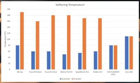

I recommend this video by CNC Kitchen, as it shows an interesting, accurate and detailed, side-by-side comparison of heat deformation of custom 3D printed test samples, printed from various materials:
  • PLA
  • PETG
  • ABS
  • HT-PLA
  • 3dkTOP
He even CNCs a custom, yet simple, test rig in order to carry out the test.
Well worth a watch.
The results for the various filaments can be seen in this graph, taken from the video:
Graphical summary of 3D heat treatment tests
In summary, the annealed 3dkTOP filaments perform very well, without failure, and annealing PLA helps considerably (although some shrinkage is incurred)
